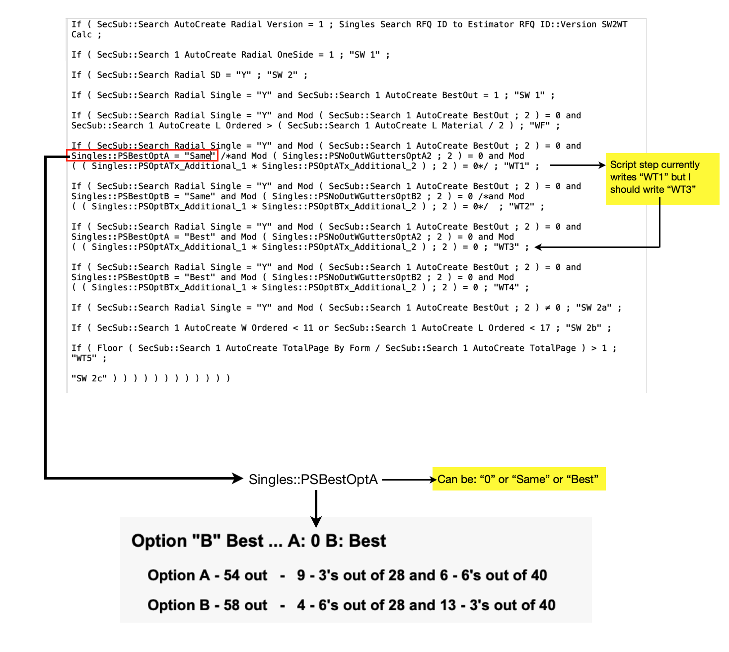

Singles::PSBestOptA = "Same"
"Singles::PSBestOptA produces the following; a "0" or "Same" or "Best" and  I've test with "number" and "text"
When "Singles::PSBestOptA" has a "0" in it, FileMaker allows ... meaning "0" = "Same" ?? what, impossible but I've tested it.  Changing "Same" to "t" FileMaker does not allow or match or whatever is going on ... ????
I need understanding here. FileMaker should not allow; "0" = "Same" yet it does ???
Can someone help me with this ...

Guessing here. Try using Exact ( Singles::PSBestOptA ; "Same" ) or whatever you are testing for.
Or post a sample file.
The best translation I can do at this moment ... I will try "Exact" Josh and advise.

Why are you using nested IFs?  In even the most complex solutions, I've never needed to write something that ... strange.
added ... BTW, that isn't a script step, that is a calculation.
You have fields with different numbers at the end ... prime example of a structure in deep trouble.
Edited by LaRetta
The Case ( ) function is better suited for your needs here. However, a nested IF ( ) can work.
Honestly, the calc looks like it should calculate as you said, assuming the data is as you claim. To diagnose further, we really need to see the file, or a sample of it that demonstrates the problem.

Actually it's script step 572 and I have to look for all these possible conditions on the Press Sheet.
This is the best I can do ...

Josh I tested "Exact" but same results ... ???  Confused.
I checked or change the field to text and number ... same.
I've attached a test file with a simplified version of the issues, please have a look and advise.
I still have to test the whole calc ( nested IF's ) ... so until I solve this issue I could have more.  Any assistance here I would be grateful.

Your calculation returns "SW" because the test expression evaluates as False. It evaluates as False because the condition:
Exact ( PSBestOptA ; "Same" ) = 0
evaluates as False when PSBestOptA contains the text "Same". This is because the Exact() function returns 1 (True) when the two texts being compared match - and 1 is not equal to 0.
You will get the expected result if you change the condition to:
or simply:
PSBestOptA = "Same"
(you only need to use the Exact() function if you want the comparison to be case-sensitive).
Comment, my apologies ... the stupid test file I created I entered in a "zero" by mistake  ... It was suppose to be a "1" and yes the test file works ...  I am so tired chasing this problem, the actual file does not work for some stupid reason ... I tried both "equal" and "exact" and they both fail, unfortunately I can not produce the actual file ... I'll have to see if there is somebody local who can take a look at this calculation.  Thank you.

My apologies ... comment,  Josh, LaRetta, the test file was my best efforts and it failed, and when I noticed the error I made on the test file, my laptop almost went out the window ... I was !@#$, so now what do I do ?  The calculation was working, completely lost even in communication.
Well, the error turned out to be human ( illogical ) ... not computer ( logical ).  This is were all my problems with FileMaker reside.  Illogical, not Logical ... Logical is easy to test ... 2 + 2 = 4 right ...
The customer wanted Two results ...
1st - Provide the best possible number out ( business cards ) from certain materials in thier material list ( stock ).  2nd - From this best possbile number out "List", which one was the best price ( cheapest ).
I forgot that for the "Max" function and the "Min" function to work correctly ( meaning my understanding  which could be wrong ) was that you needed to be on the 1st record of the found set ( the relationship ).
I had to loop though the initial found set ( relationship )  to calculate the "Best Out" and set the "Price" on each record ( material ) then I went to the 1st record to set the "Best Out" and "Best Price" ( Max / Min ).
Since I didn't need to know the primary key at the time I calculated best out and best price I coninuted on with the script, and when needed, I looked at the record where I was physically on the 1st record ... Oops !
What was so confusing, the calculation worked ( Test File ) when there was only one record in the found set but when there was more than one and I needed to be on record id lets say "pk_16" I was perfroming all my calculation based on pk_1.
So I am sorry for being human ... the test file forced me to re-examine my thinking and I had to step through the script thinking from a basic foundational building block concept when I realized the error.
I am now building a new relationship based on the best out and price to capture the primary key which I will be using to calculate where my current "Error" calculates.
