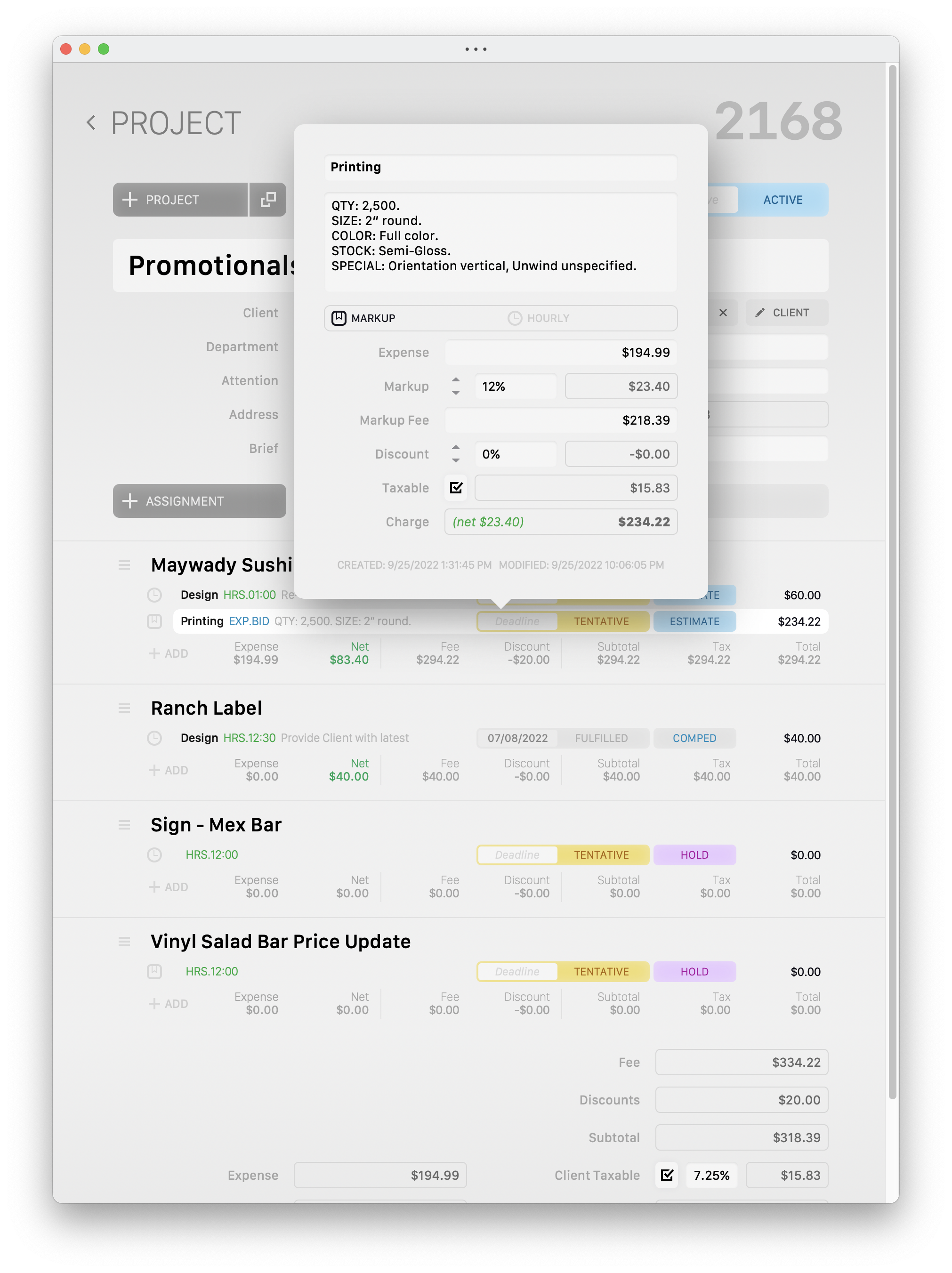

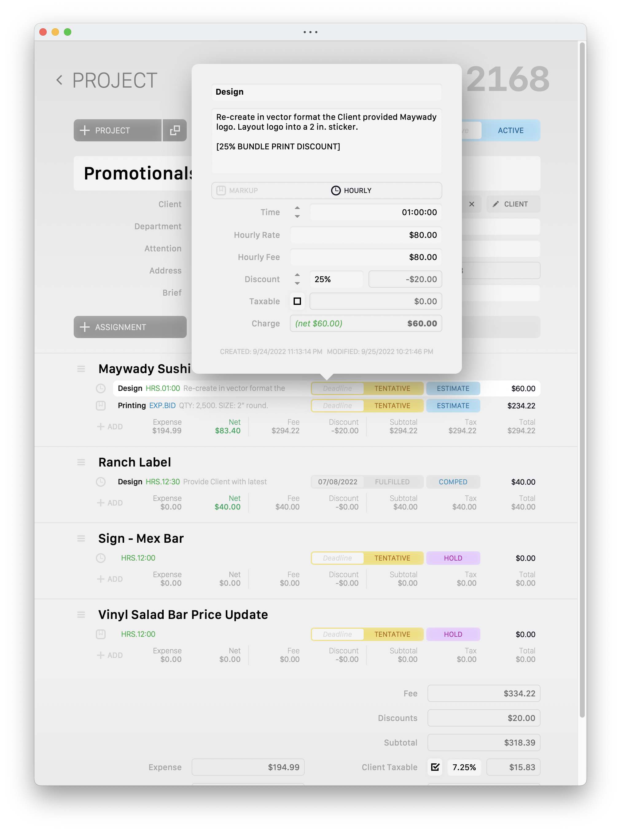

OK, great! Seems like I'm on the right track then (screen shots of my in use solution) attached.
I'm currently keeping the data for expense/hourly/fee so if User switched back from one to the other, they would not have to re-enter data if they did not want to. But maybe I should strip the data?
I love the idea of being ridged on showing data specific to method of billing chosen. I was just driving myself crazy thinking, what if there is an expense, but did not wanna bill via Markup, but rather via Flat Fee, etc...
Thank you! I'mma try and un-complex my brain on this, lol.

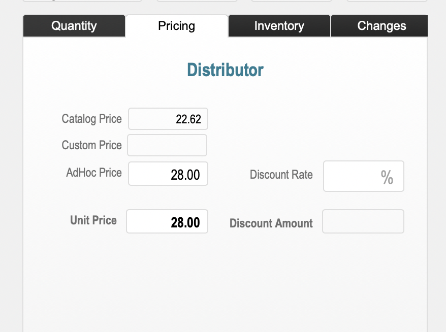

In one system I did years ago depending on the product and the client a product/service price could be looked up from catalog price, or custom negotiated price determined by a Purchase order that has a from and thru date or an Ad-hoc price, and if manager approved even a discount percentage. This would derive my unit price, which in this case would then be multiplied by the quantity, to get the line total charge.
Calculating and having these values on the line items do provide an extra element of analytics to provide insight on how much you have discounted your fees or rates.
Flipping things over from the point of view of your pricing catalog you can determine if there is trends on giving discounts on products / services. Depends on the use case and how many people have such permissions to alter prices. But it is something to keep I mind.
Not seen by the customer of course we also included the cost basis of at least physical sold goods as a data point in the invoice line item. This way when we do annual price increases looking at historical data we could maintain costs as they were.
