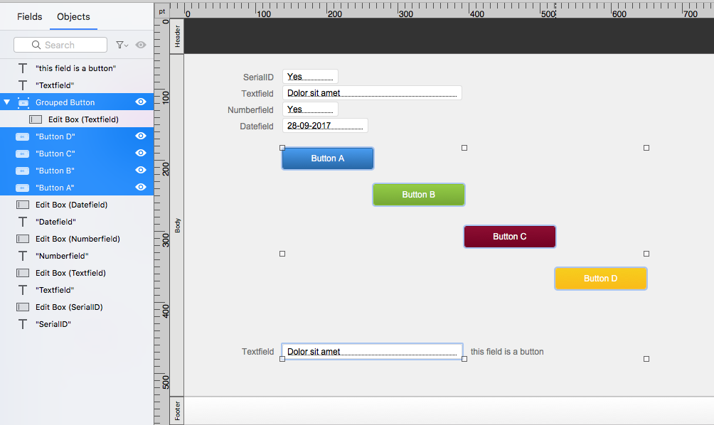

I had no problem changing the fill color (for example)  of the selected buttons shown in the above screenshot all at once. I am using version 18. I am not aware of any changes in v.19 in this aspect.

I think you may be talking about a grouped button. A grouped button has no graphic attributes of its own. If you press tab after selecting a grouped button, the selection changes to one of the objects in the group (typically a field) and you can then change its graphic settings. You can also use the Objects tab to select the grouped field directly. Or just click again inside the selection.
It is true that you cannot select simultaneously multiple fields from different groups. However, you can modify one of them and then replicate the changes to others using the Format Painter. Or, as suggested earlier, modify the style.

I don't think so, because the result does not fit what you described earlier. If I define a rectangle as a button, the resulting object is:
and I have no problem ungrouping it and getting the original rectangle back. Or selecting the rectangle within the group and changing its graphic attributes.
