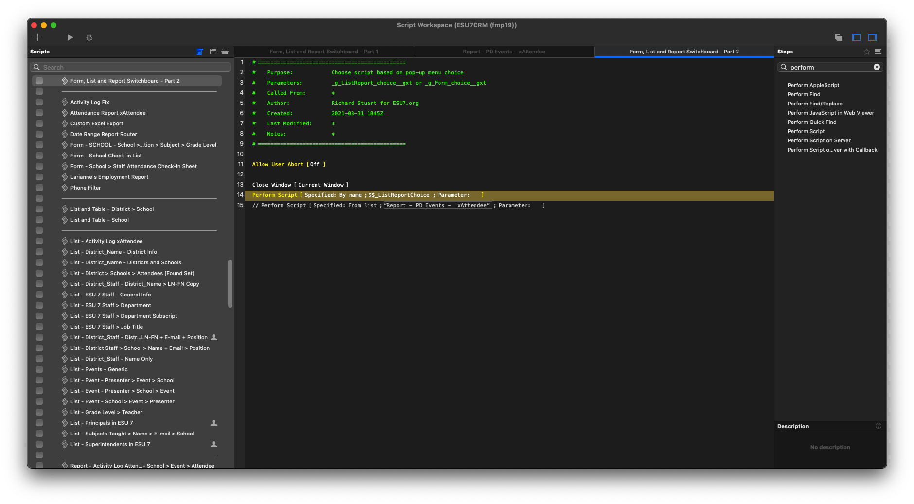

Actually, I'm running v20.1.2.204, but the newest version isn't available in this site's Account / Profile's pop-up menu. I grabbed the help menu link from v16 'cause I assumed Perform Script wouldn't have changed in the last handful of versions. (My mistake for assuming _anything_.)

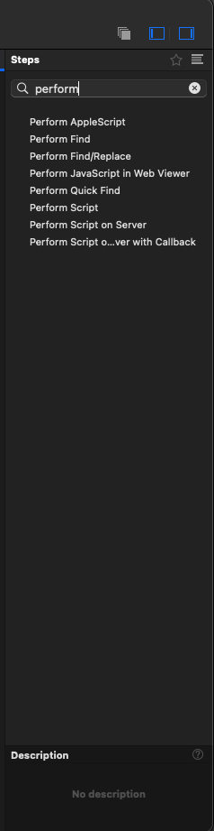

I'm beginning to think, though, that I may have to reinstall this version to see if there's a bug since when I pull up the available scripts, there isn't a Perform Script By Name choice. (See below.) I also sometimes can't access the "blue dot" on the right side of a command to enter parameters--I open and close the Show or Hide Steps Pane but to no avail; I have to quit FMP and reboot it for it to come back.
I've also included the error message I get when I try running Perform Script with a global variable.

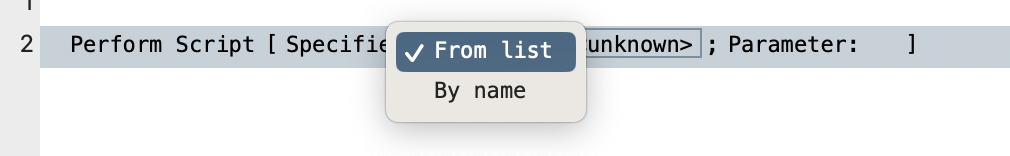

Choose Perform Script you have the option By Name or From LIst
Yup, that's what I did.
The error message suggests that the variable does not contain the correct script name. We don't see how you set the variable, nor a full list of your script names, so...
