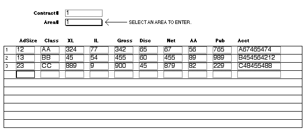

I might be totally missing the mark, but can't you use a ten row portal with the fields you described (see below)? Then you can get the aggregate data however you want; with Sum() and Count() functions.

For a portal solution, the list of fields you have would be in a related table (related by contract# and area#.) In my earlier example, the Area# field is a Global. The relationship to the portal uses the Global as part of the relationship to the related table. See ER Diagram below.
