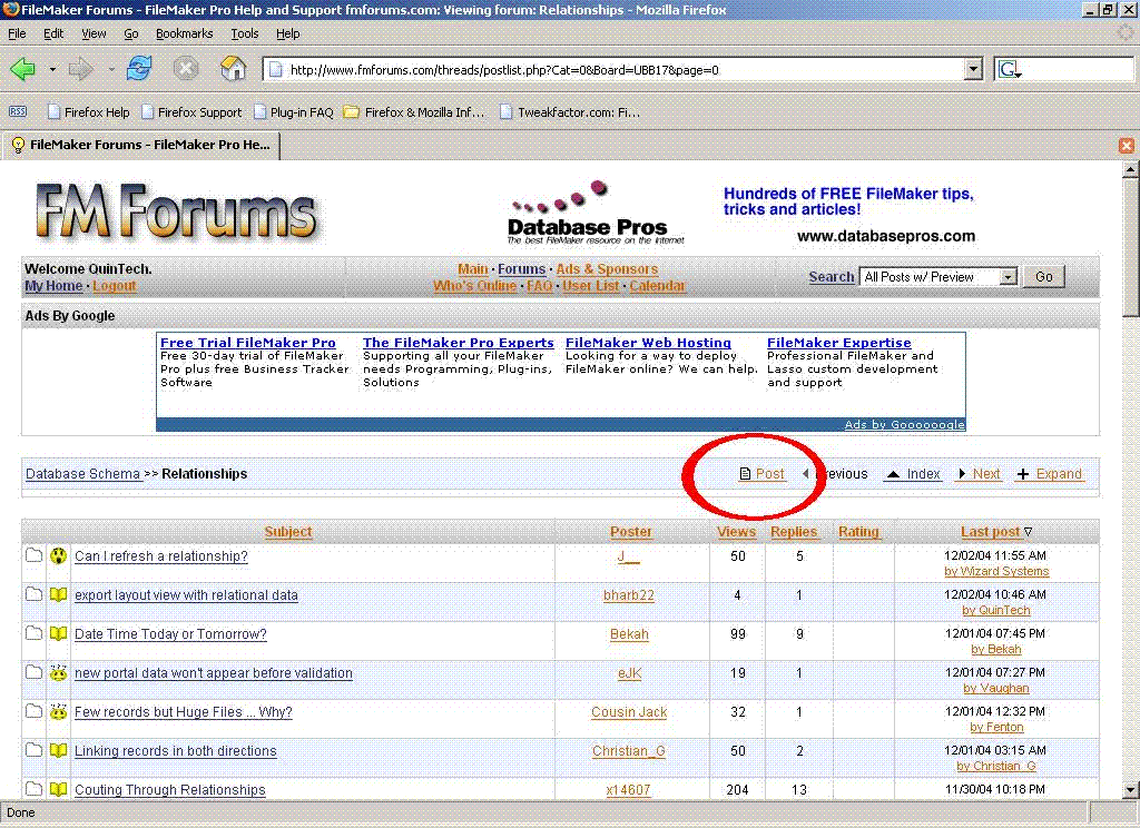

Sorry, I did not see anywhere to start a new thread on this web page. New to this forum.
Hi, Wizard. It's on the forum main page (see attachment).
