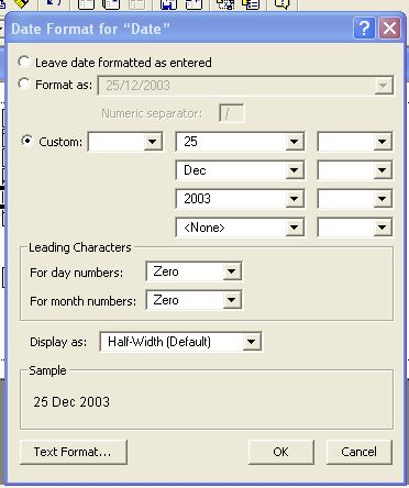

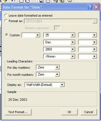

February 25, 200521 yr I should be ashamed I know about placing a question regarding these most simple of fields when you have such straightforward formatting tools!! But this is ukdave (me) and if I cannot understand something I will put my hand up and ask - until I do understand. Please find attached 4 small files showing (Oh No! I see I am only allowed 1) (a) the formatting settings I used for Date and Time and ( the results of keying in information (not necessarily the way one should) nevertheless keying it in the way someone perhaps using the database might do. After all they are not expected to go into detail they just see the time as say 2.35 p.m and key in literally 235 or 2.35. Come to what I mean later. My understanding of what would happen in most databases once a default layout was prepared is this. It would automatically convert the entry (providing it was reasonable of course) - to the Date or Time format settings which had been prepared for it. Otherwise if it was obviously outside of anything that a program could reasonably interpret it might give a suitable Error message asking for a Date or Time format to be entered. Now for me that meant if in the example I have attached for Date, keying in say 25 Dec 2003 would show that date. It didn't. Instead it tried forcing me to enter in first 25/12/2003 which it then converted to 25 Dec 2003! I know I am a beginner - but I really cannot see much sense in that. Day to day users must surely expect to just enter any reasonable format and think that the program will just change to the appropriate format immediately without subsequent intervention. On Time I had it set to the 12 hour before AM and after PM setting. Keyed in 2.35 and up came 12:00:2.35 PM. Really makes little sense to me. So it is on this basis I decided to post because obviously I am definitely misunderstanding the whole concept and need guidance from those who know. Hope you can explain simply for me please. I know this is BASIC but I cannot see any sense in going further into my studies until I grasp the simple essentials. Many thanks. David 1file attached!
February 25, 200521 yr I think you are assuming that computers are smart. They are dumb but very fast. They do what they are told to do. A little about Date and Time. Date is the number of days since 1/1/0001. Time is the number of seconds since midnight. Filemaker takes this information and displays it in the manor you select for date from the dialog box you show in your enclosure. This does not change how the data must be entered. The programmers limited the way data can be entered into date and time fields because there are so many ways they could be entered. You can setup your database to use text fields for data entry and calculation to convert them to date or time. You can also use the auto-enter by calcualation replacing existing value. This is somewhat limited.
February 25, 200521 yr Author ... ...This does not change how the data must be entered.... Thanks Ralph that's the bit I was after - we have to make it clear to users of a database the way we want the solution used. Follow all that and understand more now. Just taking it a little further please. I suppose one idea would be to put a small text note beside the entry box suggesting ways to enter the time or date. And for anyone following this post - I have discovered why I ended up with that 12:00 in front of my TIME entries. It was because I had entered in testing the figure 2.35 instead of 2:35. Entering the latter gave a correction situation of 2.35 AM and had it been 14:35 then I would get the 2.35 PM indicator. Once again, thanks for explaining all that to me - I can now continue with my studies of evaluating FM Pro 7 - I only have 8 days left to do that! David
