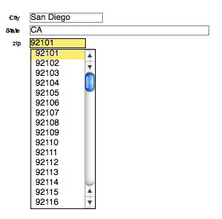

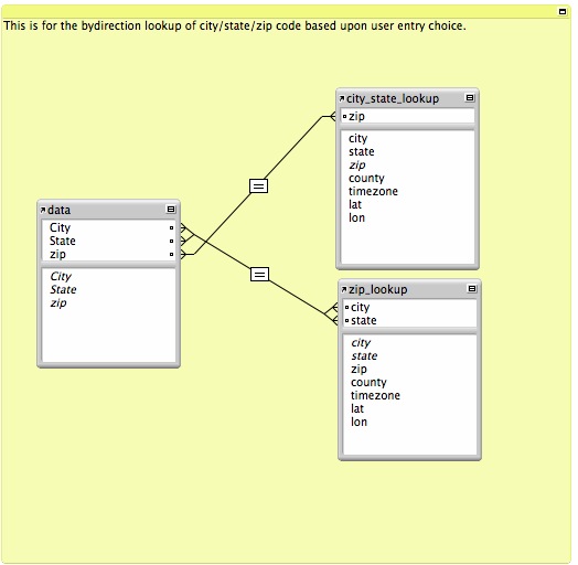

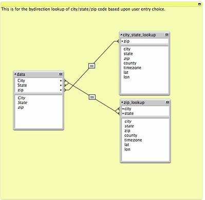

November 27, 200520 yr Description: You have Fields in your DATA table [tab]City [tab]State [tab]Zip You want to lookup the City and State based upon the data entered into the zip code. Set up the standard relationship... "data" table to your "city_state_lookup" table using the zip code as the match field. Now you want the inverse to trigger a lookup of the zip code or at least the first matching zip code based up on the city and state entered. Setup another table occurrence of your zip code table "zip_lookup" to your "data" table using the city and state fields as multi-predicate relationship. Then in your auto-enter calc field of the zip code field in your "data" table enter this: CHECK the box so that it does not evaluates if referenced fields are empty but UNCHECK the box that always replaces. Case( Get ( ActiveFieldName ) = "zip" ; zip; Lookup(zip_lookup::zip); LookupNext ( zip_lookup::zip ; Higher ) Now you should be able to lookup from both directions... I too always want people to use the zip code because it is more precise key to do a lookup but it looks odd if you have the tab sequence skip the City/State fields or you put the zip field first. I think this will help... Also you now can define a value list for the zip code field so that when you have a valid city/state you can see a short list of all the applicable zip codes. Hope this helps.. Working Under: 8 Advanced Solution Status: Beta Pre-requisites: Author(s) Ocean West Date: 11/27/05 Credits: Erik Wegweiser for the challenge. Instructions / Other Info: Disclaimer: FM Forums does not endorse or warrantee these files are fit for any particular purpose. Do not post or distribute files without written approval from the copyright owner. All files are deemed public domain unless otherwise indictated. Please backup every file that you intend to modify. Bidirectional_zip.fp7.zip
November 27, 200520 yr Author slight correction... Case( Get ( ActiveFieldName ) = "zip" ; zip; Lookup(zip_lookup::zip); TextColor ( zip ; RGB ( 170 ; 0 ; 0 ) ) ) This will keep the value of the zip field but color it to "RED" to indicate that it is an invalid City/State combination or that there are no zip codes based upon such.
