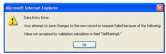

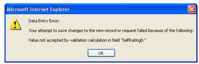

Well, I spoke too soon. I get the attached message when I try to log out, even though I have gone back to that rating field and taken out the rating since there was no measure associated with it. (It lets me save the record without any message but won't let me log out.) I'm not sure which validation isn't passing though.
Stephie
