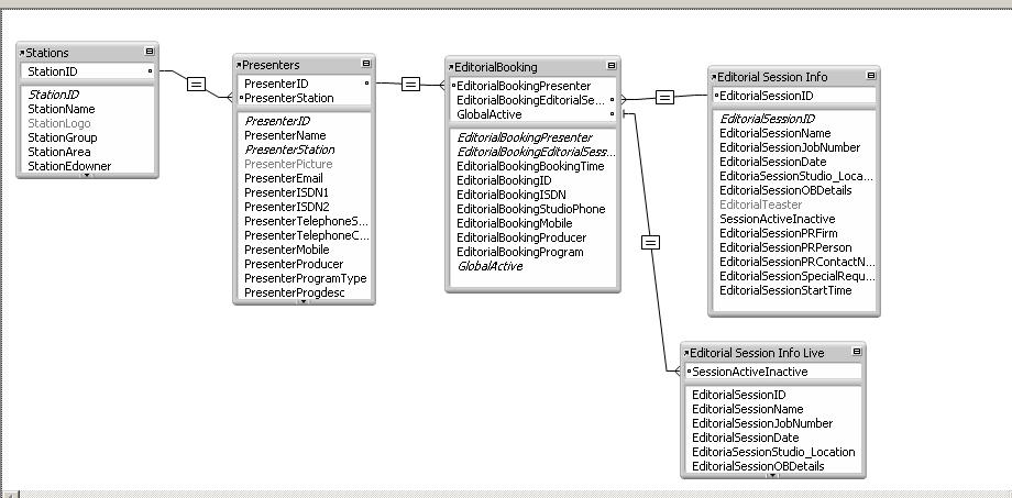

thanks for doing this for me I have had a good look at your example, I like the way it works. Unfortunatly I can't seem to impliement it in my database. I think the problem is that I am trying to use it in a join table.
I have attached a screenshot, if you are able to look. I would upload the database but it is quite large.
Daniel
If field, SessionActiveInactive has been properly entered with the data Active or Inactive, and the global field has been set to the word 'Active' then this relationship should work.
John
