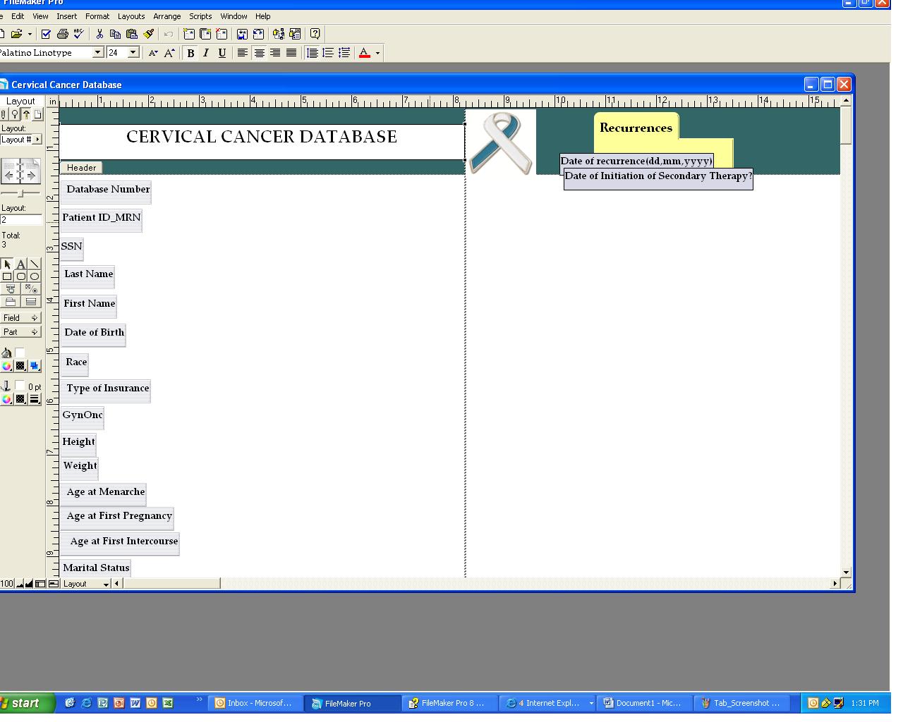

Hi, attached is a screenshot... The Yellow tab called "Recurrences" is what I'm having trouble with. See how there are fields sitting on top?
I need to figure out how to make the tab work. It does nothing in Browse Mode when I click on it!
Thank you,
Alisun
First of all you only have one tab defined on the layout. As said earlier you need to define multiple tabs. Secondly, the tab is small.

YES, your attached sample is EXACTLY what I meant by needing a tab.
The question - What steps did you take to create the tabs in your mock file??

1. Go to layout mode.
2. In the status area on the left, select the tab icon. Left button above 'field' and 'Part'.
3. Drag and draw the tab to the size you want
The Tabs attibutes window will open up automatically.
4. Enter the name of your first tab where it says 'Tab Name'.
5. Click Create.
6. Enter the name of the second tab where it says 'Tab Name'.
7. Click Create. etc etc.
8. You can mess around with the justification and the appearance.
9. Click Ok when done.
10. Now you can drop and drop the fields on the tab that you want. You must do this is Layout Mode. You have to make sure that the whole field fits ontop of the Tab layout area. Click on the second tab to put fields on the second tab.

Horray! I got it! Thank you for all your help and listing the steps!
I created several tabs, and made them and the whole area BIG ENOUGH so that the fields that I wanted to drop in would fit. It worked!
