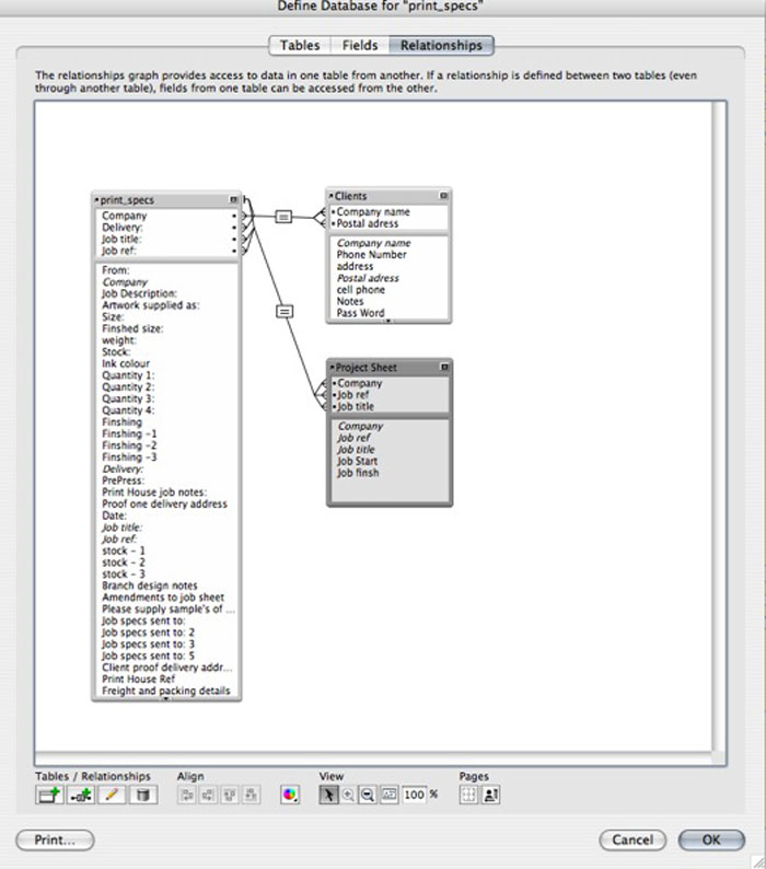

February 23, 200620 yr Hi, I must be doing some thing wrong with my Portal and relationship tables as I not getting data showing on my portals does any one have any tip attached are some screen dumps regards Hacky ;) Edited February 23, 200620 yr by Guest

February 23, 200620 yr Author Hi Lee I have upload another couple screen dump of the relationships see what you think???, (not to keen to up load the FM file as it has client info on it but... may be I can get around it by creating an new data base and striping out some of the data... i will do this if we need to.....) thanks for time Cheers Hacky ;) Edited February 23, 200620 yr by Guest

February 23, 200620 yr Hi Hacky I just had a sneeky-peek at your file. I assume that it is the portal at the bottom of the client layout that you are having difficulty with. I cannot quite work out what you are trying to do but the first thing to change is that the fields you have placed into that portal are fields from the project sheet relationship and the portal is formatted to show fields from the print specs relationship HTH Phil

February 23, 200620 yr Author Hi Phil and Lee I have just add new clone with some data, The Portals is in the client layout area I was wanting to bring up a table of all projects having >company< >job ref< >job tile< and also having them as the relationship data links accross the tables ....... if this correct thanks for time again Cheers Hacky print_specs_Clone.fp7.zip
February 23, 200620 yr Okay, I review the latest file. First of all, do not base a relationship on a company name. They can change, be entered wrong, etc., it is better to use a unique ID. First Create a Client ID field in the Project TO, Next, populate the Client_Id (I changed your ID field to this in Client) with a unique number for each client. And be sure to use the same number Project TO Next, create a Relationship from the Client TO to the Project TO based on this new Field Next, change the Portal from whatever it was to this new Relationship. Next, choose each filed and change them to the New Relationship too. Here is your file, Modified as I explained above. HTH Lee print_specs_Clone-1.fp7.zip
