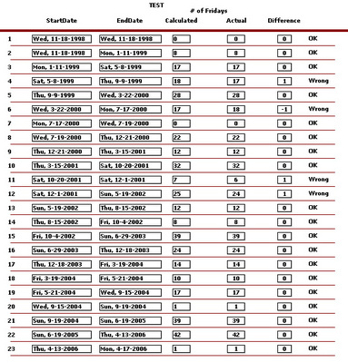

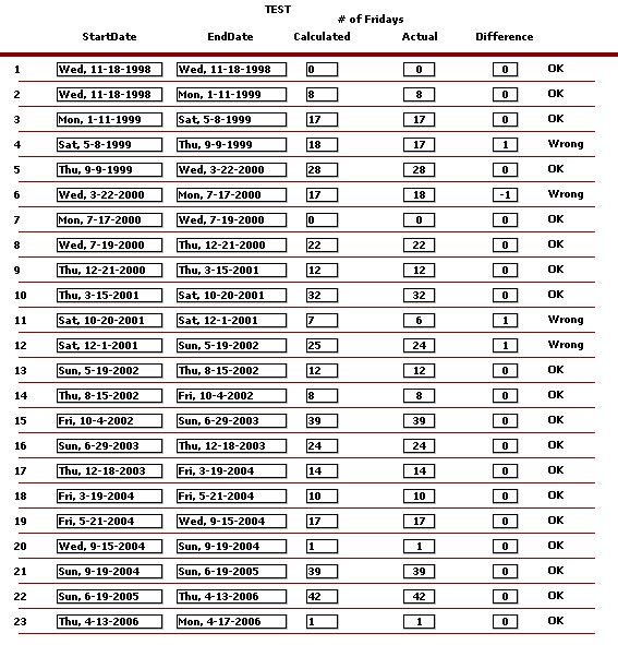

Based on Veteran’s posted solution, I came up with the following formula:
Int((EndDate - StartDate + 1)/7) + (Mod(6-DayofWeek(StartDate),7) < Mod(EndDate-StartDate + 1, 7))
I have 23 time intervals in my database so far. The attached jpg. file shows the number of Fridays for each recorded time interval as calculated by the formula, compared to the actual values looked up by me in a calendar. As you can see, four of the 23 calculations are incorrect. I have double-checked my manual counting of Fridays. Where have I gone wrong?
Sincerely, Rags
Sheesh, do I have to do EVERYTHING myself?
You have two mistakes: first, you did NOT adapt the ADJUSTED definition of the x variable:
x = Mod ( a + 7 ; 7 )
Had you done this correctly, your formula would look like this:
Int( ( EndDate - StartDate + 1 ) / 7 ) + ( Mod( Weekday + 7 - DayofWeek( StartDate ) , 7 ) < Mod( EndDate - StartDate + 1 , 7 ) )
and hard-coded for Fridays:
Int( ( EndDate - StartDate + 1 ) / 7 ) + ( Mod( 13 - DayofWeek( StartDate ) , 7 ) < Mod( EndDate - StartDate + 1 , 7 ) )
This should return results similar to your manual counts - except for the example in record #6, where I am quite certain your "Actual" count is the wrong one.
