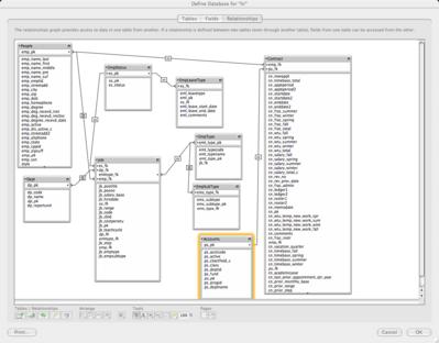

On several of my posts, the responses given referred to Table Occurences... something that I know nothing about. I don't know how to create a table occurence or when/why I would need one. I have attached a screen shot of my relationships, and if you could provide any feedback, I would really really be grateful.

A table occurrence is EVERYTHING you see in your graph. Tables can not be accessed - only occurrences of them. We also sometimes call them TOs which can confuse people. :wink2:

You've got Table Occurrences (TO for short). That's what the gray "boxes" are on your graph. They are a reference to a particular base table. The "relationships" are the lines between any 2 TOs, defined by double-clicking the little white boxes in the middle of the line.
A TO can have many lines, going in different directions, to other TOs. Hence it's not the same as a "relationship." You can only say exactly what record set will be produced by specifying an originating TO and the destination TO.* There can only be 1 line path (relationship)** between any 2 given TOs. Otherwise it would be a circular relationship, ambiguous, so FileMaker won't allow it.
*The TOs do not have to be adjacent however. A path through intermediate TOs is still a valid path.
** When you pass through intermediate TOs, what is the "relationship"? It is the logical result of all the intermediate ones. In 7/8 talking about "relationships" is really talking about the entire path. Hence you sometimes have to say, "This is the beginning TO and this is the end TO, and you'll have to look at the path on the graph." (Or use a TO naming convention that clearly specifies the entire path; but still, you often need to look at the graph.)

You've got a few relationships with < in them, between IDs. That seems wrong. Also, you would not link an Employee directly to a Job, unless there's only 1 employee per job. But it's hard to say much about someone else's structure when one has little idea what the concepts are. "Job" especially is an ambiguous (my word for the day apparently) term.
One other thing. Please collapse your TOs on the graph to show only the keys involved. It's Control (or Cmd) T. Select All first, if relevant. It takes up so much less space, and is easier to arrange.
So if I want a person to have job information and contracts... (one person can have more than 1 job and contract and also- and no- there's not only 1 employee per job... there could be 25 people with the same job, but different salaries or something)--- what would I have to change or implement?
Thanks in advance
You would need a "join" table between People and Job. It would have the People ID and the Job ID, tied to the relevant primary ID in the parent table. And any other data that belongs that that particular combo, such as the date(s) involved. And possibly its own serial ID :)-]
When adding a Person to a Job you're actually only adding a record in the join table. This can be done from either side, choosing the ID of the one you don't have, while allowing the ID of the current parent to be auto-entered by a portal with "Allow creation of related records."

the job table records are unique for each person... not standardized.

The term "job" is so vague. A "job" may last 15 min., it may last 10 months, and have hundreds of "tasks" within it, or even a hierarchy. "Job Assingment" is a better term, because it signifies 1 particular "job" (whatever it may be) assigned to 1 particular person, at 1 particular date-time.
Since the Job Assignment (JA) is NOT the "job" itself; UNLESS there's only 1 person assigned to it, and assigned only once, then you would need a separate Job table, and JA would be the join table.
