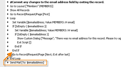

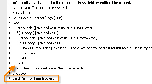

You needed to put the "send email" in the loop (see screenshot).
The variable gets set and overwritten for each record you visit.
What was your intent: to add the email address to the variable for each contact? Or to set it for each contact and send each one an email based on that?

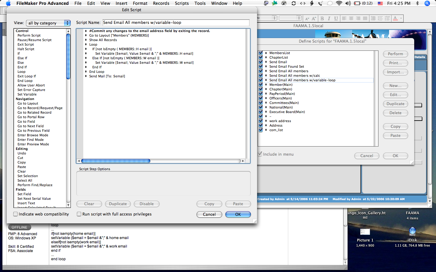

I tried it, I must be doing something wrong.
attached picture
Your missing the record navigation script steps.
(that's what I implied with the "..." in the loop)
After "show all records", do a goto record[first}
just before exiting the loop do a goto record[next, exit after last]
That worked. So I have three different ways to accomplish the same thing. Thanks for helping me to understand how to use a variable.
