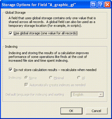

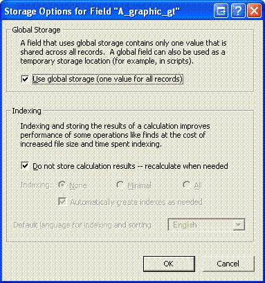

Can someone tell me how the developer of this solution, managed to store his calculated global as un-stored?
Interface_Rad
I spent to long trying to figure out why I could not replicate what was done in this freeware, and then when I checked his global calc settings I discovered my problem.
Anyone know how this was achieved?
I am guessing that you were using FM7 (update your profile...)?
That was a new feature introduced with FM7 - global unstored calcs.
-Raz
*Calculations defined with global storage options display values calculated using the last modified record
added fm help text

To my knowledge you can not have both a calculation field that has both the global storage checked as well as the "do not store..." box checked at the same time.
At least my version of 8Av3 will not let me check both at the same time
Sorry- thought that it was the whole "set a calc as a global" thing coming from FM5 you were talking about.
Re-read the post and checked out the file in FM7Dev and FM8av3, and it is odd. Also, once one is unselected, I can not get it to go back to its original doublechecked state, and its behavior is indeed specific to that doublechecked state.
I will try and have a look at it later this eve as well.
Thats ok...I had the same results, I can not recreate this solution because I have the same problem you did when trying to check both options.
