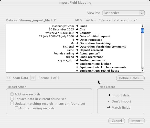

Here are the dummy files:
- a clone of my database
- a clone of the text file that I have been trying to upload. It's structurally identical but I have edited the data to protect individuals' privacy; and there are just two or three records
- a PDF showing the correct ordering of fields being imported from the text file to fields in the database
I have put two records manually into the database. You'll see that when you search in the comments field for "textyoucanfind2", only one record gets found. However, if you import the text file and search for xxyxxx, which is in the comments field of all imported records, the text is not found.
This is the essence of the problem.

The import was of course effected, so All I did was line up the Email, and the Further Comments, and imported. The Find for

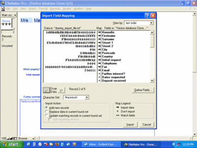

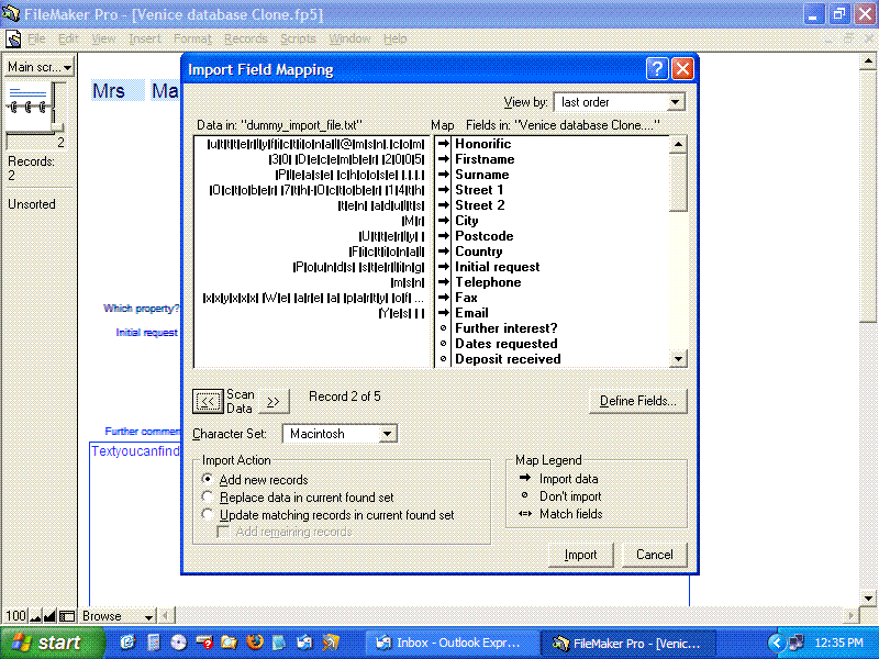

Both your fp5 file and the text document were read-only. After corrected, they opened fine. But no matter what import method I tried and no matter what extension I used, I couldn't even get a map to it. Maybe it's because I'm using 6.0v3. Here's my results. Sorry I couldn't help you isolate your problem.

I used the Tab Separated Text Format for Import, and that was another thing that was chopped off of my post.
Looking at your screen shot, I didn't see that data in the text that I imported.

Yes, my first record in the map for import matches yours, Lee. But it continues to put a pipe between each character as I displayed. Interesting. I again selected tab; same results. I even tried each of the character sets but it made no difference. I have an old vs. 5.5 around here ... maybe I'll give that a go if I get some time ...
I didn't pick up on the version 5.0.0 until just now. IMHO, 5.0 was unstable, and causing my files to be corrupted on several occasions when it Freezes while processing. If FileMaker crashes, or if you have to force quit it, it can corrupt your file. If you have ever had to Run the Recovery on this file to get it to open, then there is a good chance that this file may be.
Once I upgraded to 5.0.3 a lot of problems went away.
Your file acted like it might be corrupted when I opened it.
Have you ever had to use Recover to get it to open? I ran MetadataMagic on the file you posted, and shows that the file was not closed properly 1 time. Anyway, that is about all I can see without sitting at you desk.
