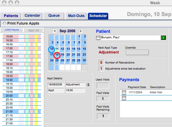

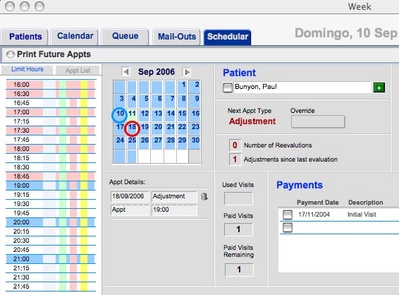

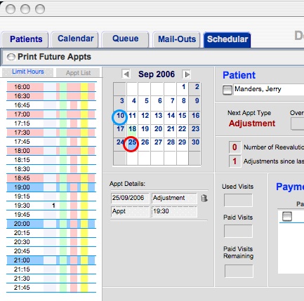

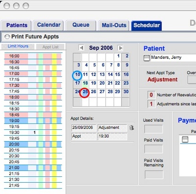

I've attached a couple of images that show what happened before I made the adjustment to my calculation and after. Notice how in the before all the calendar dates are blue. They are only supposed to have a color if the patient has an appointment that day, i.e. there is a record to match the patient Id - date. Then in the after picture the calendar is looking like it should.
But you are probably right that I could have also fixed this problem by setting the field with it's proper color rather than using a calc to give it it's color. It's just a curiosity to point out.
