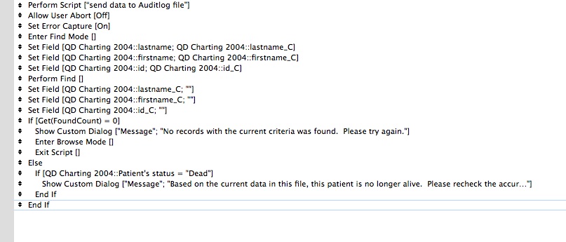

see associated list :
The value of the "QD charting 2004 Firstname" suddenly changes to "" ( empty ) !!
The fields labled as _C are actually global fields .
Do you see any reason ?
Xoomaster
I don't see anything wrong with the script, except for the fact that it breaks sometimes in your solution. More about the environment, could the issue be user specific, PC or Mac specific, or a privilege set? Does it seem to matter whether the "Run with full access" is selected?
My guess is that it is somehow multi-user related. If you take the database off line and go in on single user (unshared), do you still have the same issue?
Just some straws to grasp.
HTH
Tim

I will try to repost my original script :
http://www.fmforums.com/attachments/uploads/1166060623-script.jpg
The fields with "_C" termination are global fields.
In the post above, I see no reason for the QD Charting 2004::Firstname to change ! Do you ?

The buttom line is the firstname is changing ! The user can search for what ever, but the First name should not be changing by this script.
Somehow the First name is earased completely !
About corruption of other field, only the first name field is changing ? this is also seen at the audit trail.
I do use File maker server 8.
And no the fields are not accessable for change on that layout .
I want to find if there is something that I can fix with the script or is it the DB ?
... why don't you add an extra little bit to your audit trail to tell you if a script is executing at the time?... I think you can do that.
The way the audit trail is set up, it shows only the field value changes, and not when a script is run, but I can send a start of script event to the audit trail. hopefully that would be enough to help me figuer out if it is the script ? The biggest problem is that it happens only once every 4 or 5 months, and we use the DB for probably 9-10 hours daily !
Thank you for the suggestion.

You haven't told us why you are so certain that it is your script that is doing the damage.
Have you produced a DDR to make sure that nothing else touches that field?
You are correct, the field Firstname is not connected or used in any other relationships or settings that could cause it to change.
