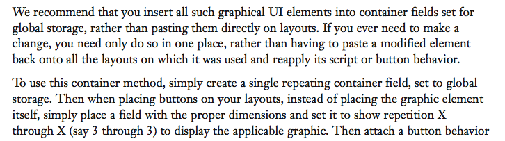

Which book says you can put a button in a container AND have it work?
Using FileMaker 8 Special Edition, page 358
see attachment this is what i am trying to do
I am afraid you are misreading the authors' intention. To your credit, they ARE using the term "button" rather ambiguously. You can put a [color:blue]graphic element into a container, but it will not retain its definition as a [color:blue]Filemaker button - i.e. it won't be clickable.
What you CAN do, is define the container field itself as a button. Or, IMHO preferable, place an invisible button (a Filemaker shape) over the field and group them together.
See the attached for an example. BTW, you don't need a relationship to show GLOBAL fields on another's table layout.
