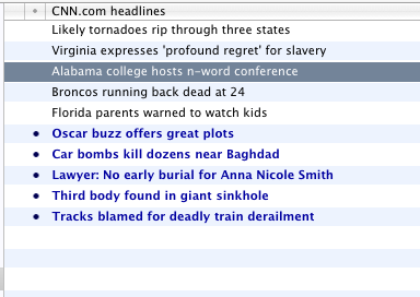

The accepted standard (at least for well-behaved OS X apps) is:
selected = highlight (background color + invert text color)
new/unread = bullet + optional bold + optional text color
