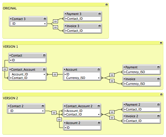

Here is an image of my ORIGINAL structure and the two structures that do work, its just that the Contact_Account database is a little difficult to manage.
Maybe this is the only way?
I don't see why you need a ContactAccount join. It's just duplicating known data. We already know which Accounts are related to a Contact: it's the Accounts in which a Contact has received an Invoice and/or made a Payment. IOW, you already have 2 join tables between Contacts and Accounts, why add a third one, with no new information?

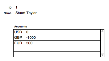

I was trying to show this information on the contact record:
Each account with the balance relevant to the contact.
That picture is a bit confusing, because it SAYS 'Accounts', but SHOWS currencies. I presume that if the contact had dealings with two USD accounts, there would be two separate rows to reflect that.
I see two questions here:
a) how to get contact's accounts into a portal?
:) how to compute contact's balance in each account?
The answer to (a) is easy. First, if it can be assumed that no one makes a payment without being invoiced first, the portal can be simply to the same TO of Accounts that is connected to Contacts via Invoices.
If the assumption is incorrect, we can define a calculation field in Contacts that lists the AccountIDs from both Invoices and Payments, and connect this to a new TO of Accounts.
The second problem is a bit more complicated. Clearly, from the point of view of Account, you need to see the transactions that relate to the Account AND to the viewed Contact. This means you need a global gContactID field in the Accounts table - and therefore the navigation between Contacts has to be scripted (at least when on this layout).
A relationship from Accounts to a new TO of Invoices:
Accounts::AccountID = Invoices 2::AccountID
AND
Accounts::gContactID = Invoices 2::ContactID
can fetch the sum of contact's debits in this account. A similar relationship to a new TO of Payments can bring in the sum of credits. The balance is the difference between the two sums.
