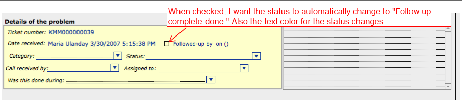

Along these same lines, the user checks a box indicating the project is complete. Is there a way to automatically change the a drop down box field with value list of project status to complete?
Does that make sense? Thanks!

Thanks for your response Mr. Vodka. I am sorry for not being clear with my question. I have attached a picture of what I am trying to ask. Thanks again for your help.
Hello,
I have attached a new modified model file.
I "believe" I have accomplished Mr. Vodka's instructions.
It is set up now so that you can select any value you want for project status unless it is marked "Followedup".
Hope this helps.
