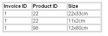

Using the record structure in your example my records will look like this:

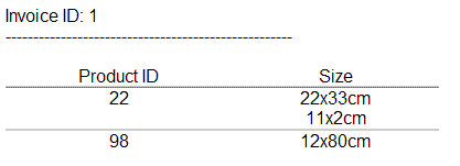

Here is how i would like it to show on the invoice layout:
with it being grouped firstly by invoice number and then product ID

You can do those types of summaries with Summary Parts.
