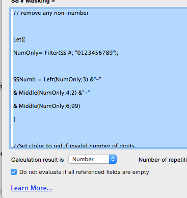

oops i spoke too soon. I see it work i.e. it puts in dashes and then disappears! if i put in numbers into ss field and then tab out only numbers appear in masking field. (i put both fields separate so i can see and click masking field) if i click masking field the dashes appear but as soon as I tab out or leave field the dashes disappear and I'm left with numbers again. something very small needs tweaking. can someone please help as I'm so close here. I'd love to add the red text if not enough numbers too but I'm happy with just the working mask if someone can please point out what's wrong.
Edited by Richard W Graham IV
mistake, couldn't find cancel anywhere
Like I said - the result must be of type Text - see where it says number in the dropdown, change that to Text and this works
I'm sorry I didn't realize there was another one in the calculation itself (number option) Thank you so much! yeah now I remember having the same problem with the phone calc... ha ha!
Thank you once again and I'm humbled by my own stupidity!
