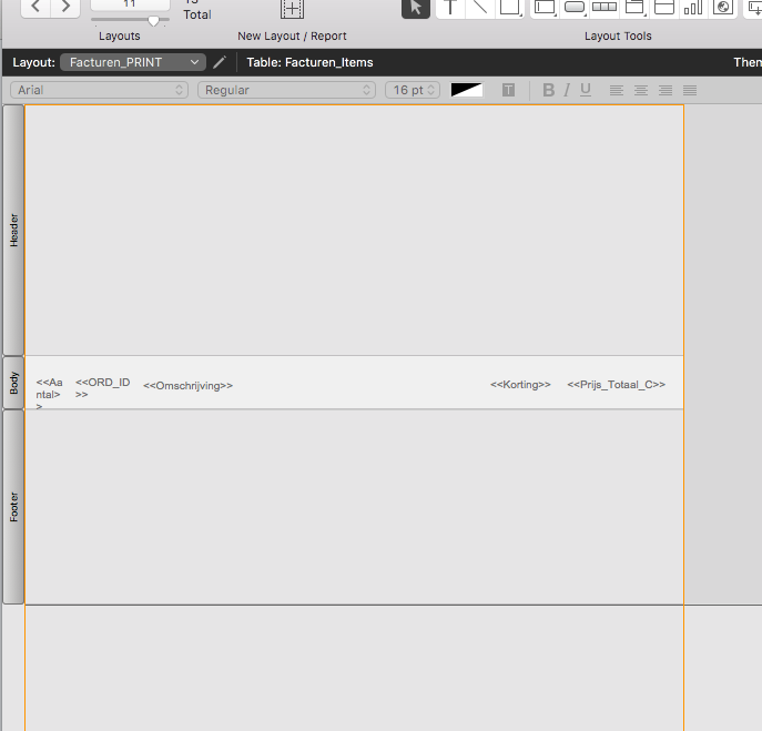

I have this right now.
It kind of works, but I can't access the field of the invoice itself.
I need them to make a summary ofcourse. Or am I totally wrong here?
The invoice fields are not on the layout because you did not put them there.
Put them there.
Put the invoice (parent table) fields on the layout.

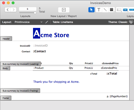

Screenshot from converted Comment file.
