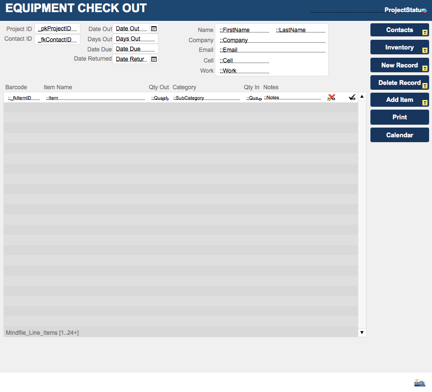

The items in the print form are not within a portal on that layout. They are the items from a portal on the invoice layout that references the line items layout. The layout is under the table for line items, however the items related to the invoice number do not appear

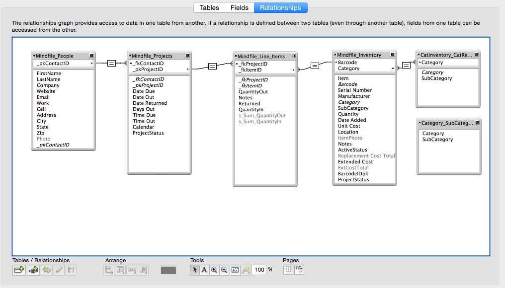

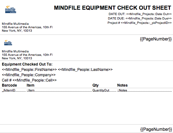

Here's the relationships table as well as the layout view of the "invoice" table and the print layout from the line items table

The real file would be better …
since it would give answers to questions like: is there a body part in that layout? Is the layout set to List view? Are there related records …? What does your script look like? etc.

Move your fields downward so they are properly within the body part – and make that part smaller (less tall) so it encloses the fields just so.
Also, I suggest you amend the script with the step in bold:
Enter Preview Mode []
Adjust Window [ Resize to Fit ]
That worked perfectly. Thank you for your help!
