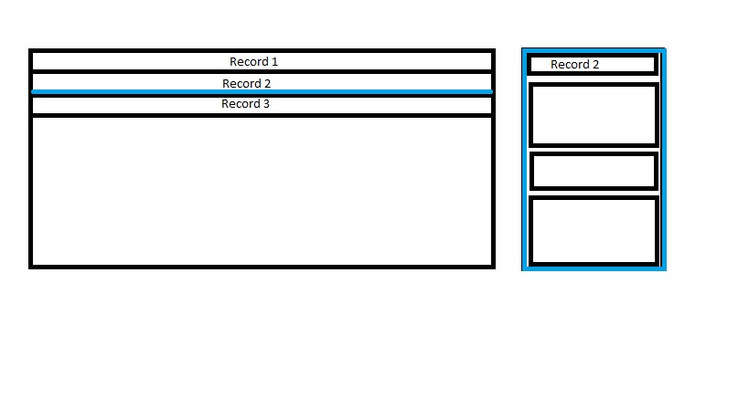

Portal_side_win.thumb.jpg.514849be9f9db6
The idea is to only show that extra info on the selected row. Now I have some questions:
* Will the layout download the data for the whole table when I go to that main layout or just those specific ones I set the list of Var to copy? In my head that was a "cheaper" way to go as it was copying just and only the select row info. I was thinking, maybe having a button next to the end of the row "show more" and only then it would load the side window?
*Would be a better aproach to have an equal layout on the main table that instead of having the tabs it would show the full info of the record? The idea is having the feeling that the whole layout of that dashboard is not changing at all.
Abusing a little bit, what is the best aproach to use on the relation here?
A Global field on both tables with same text, then with an "=" relation between these set multiple portals with different filters;
A relationship for between the tables for each portals, in this case 5 relationships each one with specific text on the portal side table to filter that specific data; (Using that one)
A single relationship between the ID field on the main table and the ID field on the portals table with a "X" relationship to show it all.

Based on the mockup and assuming that the left list is a portal and so is the right block then you'd two relationships:​
1) to all records, probably using an X relationship and a filter on the portal itself --> keep in mind that "x" relationships can be expensive if there are a lot of related records
2) a relationship from the "selected" row on the left to the that record.  You can set a "selected ID" global and relate it to the ID of the target table.
​With 2, yes the left block is a portal, how would I get the fields to display as a vertical block like on the image instead of the horizontal only that portals do?

​how would I get the fields to display as a vertical block like on the image instead of the horizontal only that portals do?
​Make the right-hand side portal show only one row. Make that row tall enough to accommodate a block of fields arranged vertically.
​You don't need a portal for the vertical block.  There is always only going to be one related record so you can just use the related fields without a portal.
Even with a portal it would work, just create a one-row portal and make it high, then fit your vertically stacked fields into it.
​That was my idea but having just the fields outside of a 1 row portal don't show the related record that I have selected on the first portal, it will show the very first record on the main table. Perhaps I have a bad relantionship set or am I using the wrong field type on the layout?
Field type on the layout has nothing to do with it.  It sounds like a bad relationship.
Here's how the flow typically is in a scenario like this:
- user clicks on a portal record on the left
- your script grabs the primary key for that selected record, puts it in a global of the table of the layout you are on
- there is a relationship from that global to the primary key of the records shown in the left portal
- that relationship will yield just one related record to show on the right (since primary keys are unique)
