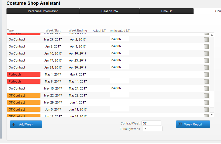

Table 2: Contract_Records: This table has 1 record for each employee week, 30 employees, 53 weeks, 1590 records. It pulls salary/wage information via the PERSONNEL ID MATCH FIELD relationship. This table is my primary workhorse, I enter on contract/off contract/furlough information here as well as hours worked and other important weekly information
Table 3: Contract_Weeks: my hope was that this would have 1 record per employee and be a summary of all their weekly statuses
While this whole database is primarily designed around monitoring the active year I also need to use it for forecasting future years (we are in a field that hires people seasonally). We currently use a big spreadsheet (see attached sample) where my boss colorcodes each cell to represent the employees status, I then enter it into the database and it does the hard work of calculating expected pay per employee and department. That's all fine and dandy if you do it once a year, however we do this budgeting practice upwards of 10 times before we lend on a final budget. I need to recreate something that will allow my boss to easily play with the weeks each employee is working and have it automatically update the salary numbers.
I currently have a portal that displays a brief sum of each week (see employee sample) but really need to see everyone together as it's a very tightly woven puzzle.
