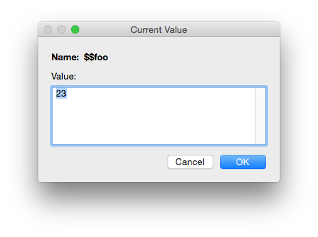

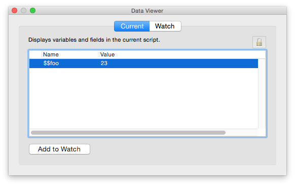

Declare $$foo, with a value.

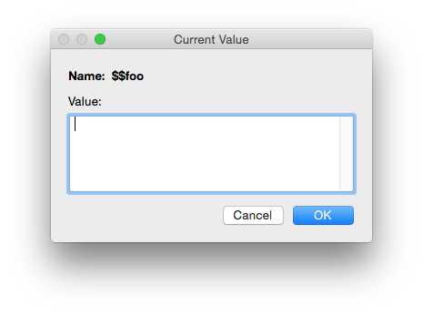

Use variable watcher (or script) to set $$foo to empty

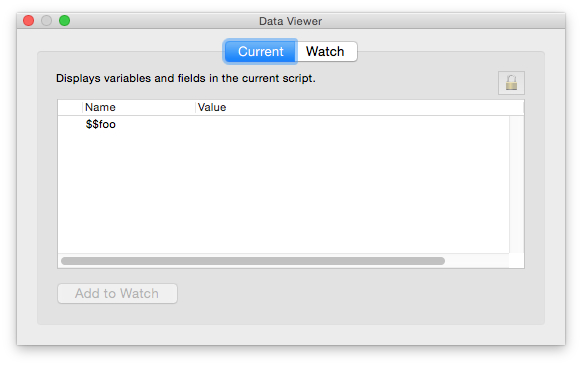

$$foo is still visible in the variable watcher.
You can even close the variable watcher and open it again, and still see $$foo and its (now empty) value.
But I agree 100% with your point. Treat it as not-existing if empty.
That's not what I observe. I have Script A to set a $$variable to a value, and Script B to set it to empty. Watching the Current tab of the Data Viewer, the $$variable comes up when Script A runs and is taken off the board when Script B runs.
I would guess there is in implicit "unset" type function that destroys the variable when it gets cleared via a script, but that behavior is not included when manually setting variables using the data viewer. The expected behavior is that setting a variable to "" will destroy it.

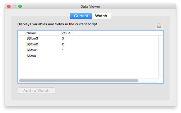

A little more detail.
If I set up this expression in data viewer, evaluate it, then cancel,
(so my expression is not stored in WATCH)
Let( [
N = 1
; $$foo1 = 1
; $$foo2 = 2
; $$foo3 = 3
; $$foo1 = ""
; $$foo2 = ""
; $$foo3 = ""
N
I get the first of the attached results.
If I eliminate the comment markers and evaluate again, cancel ( so the expression is not stored in WATCH) then the empty values are declared, - see second screenshot.
I am looking at your second screenshot and I don't see them.
Yes. That is the correct result. They do no exist.
Okay then. I guess you meant to say they were erased, instead of declared.
I guess so. We may want to come up with consistent terminology.
