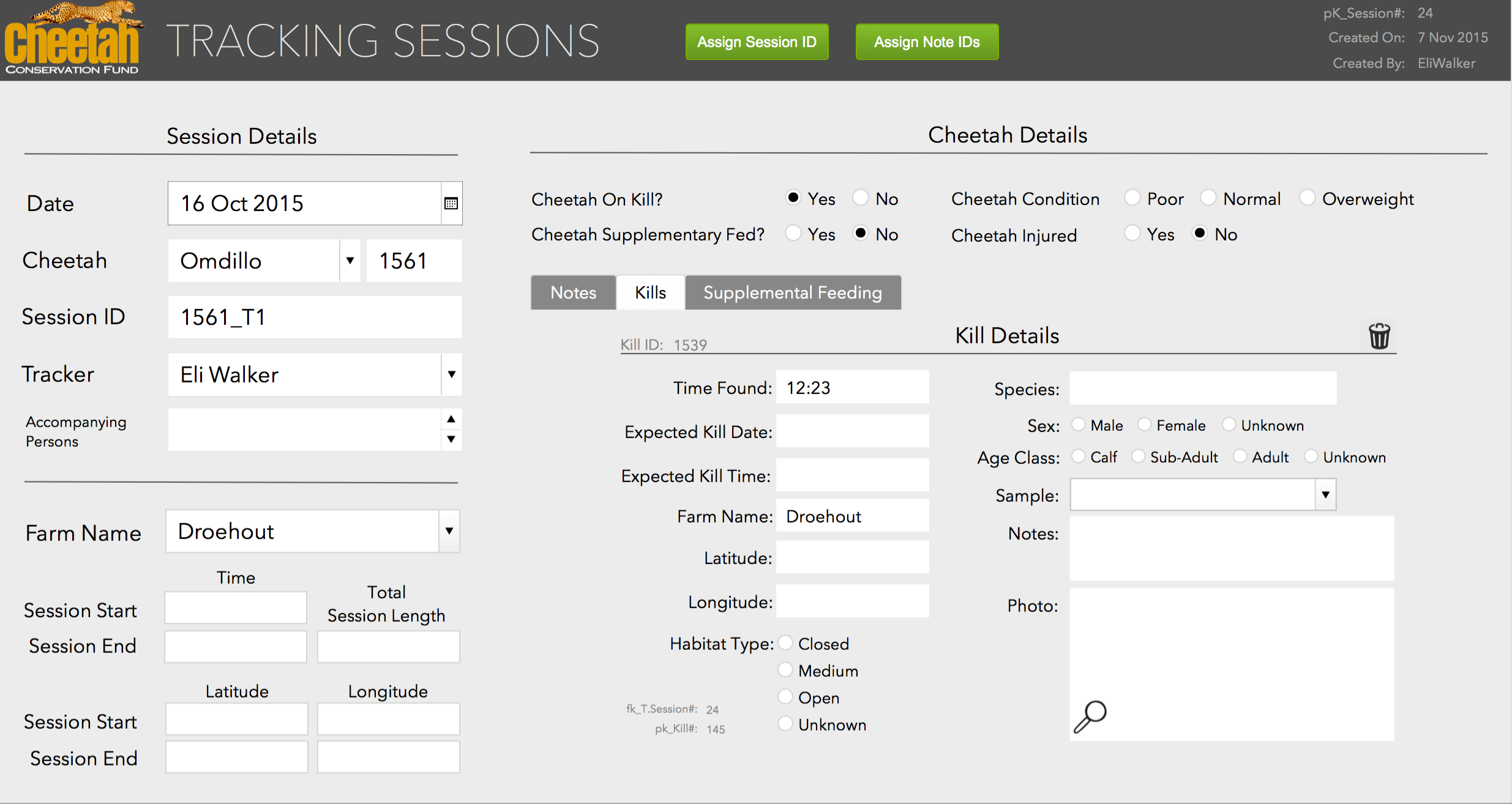

So I have a layout for 'Tracking Sessions' which contains details of each time someone went out to find a particular individual/group of cheetahs. Within this layout, I have a Tab that contains different portals to different tables of information that could be (but not always) collected during a specific tracking session (e.g. kills found, supplemental feeding, and 'Tracking Notes'). Now, because of the Join table how can I set these portals up to allow for record creation in these child tables while also creating the necessary records for the join tables? I've included a screenshot of the layout. Everything under 'Kill Details' is contained within a single portal row, as there is usually only a single kill during a single tracking session (though I guess in theory there could be more than one at some point in the future). From my experience and what I've read, you can't place a portal within a portal so how do I solve this issue while maintaining the current format (or if there is a better way of doing this, I'm all ears!) I've also included an updated screenshot of my relationship table, so you can see where tracking sessions lies in relation to kills and cheetahs.
If anyone has any advice on this, I'd really appreciate it. Thanks!

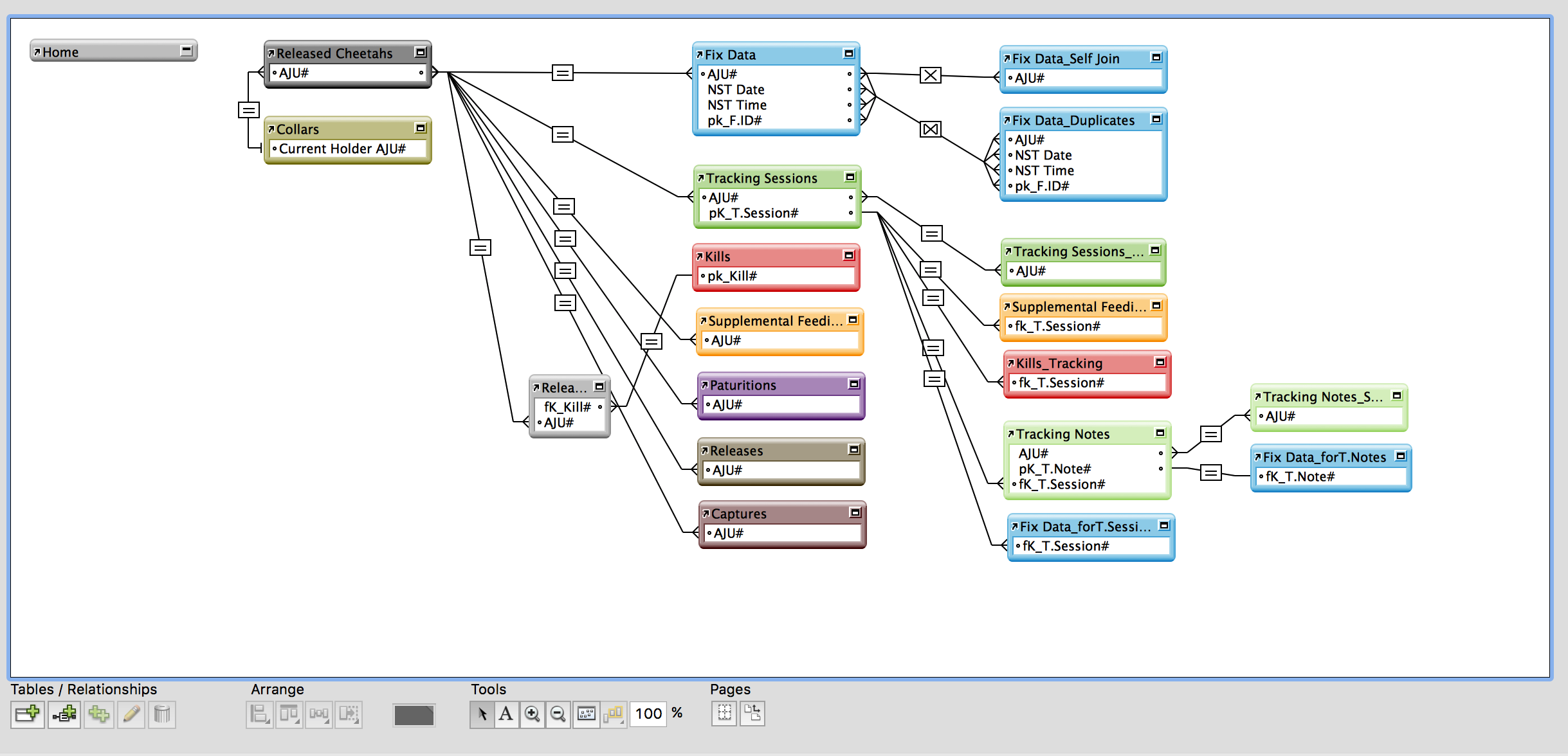

Ok, let me try to clarify. So under 'Kill Details' within the 'Tracking Session' layout, I would like to add a portal to the Cheetahs to Kills_Join table so that I can assign the cheetahs that participated to the kill, as not all cheetahs tracked during that given session would be in the kill. Does this make sense? I have attached a file that will (hopefully) illustrate what I need. There are also other tables that I will recreate this for (supplemental feedings, notes, etc..) but I thought that only one example was necessary. Let me know if something needs clarifying.
One thought that I had was just to have a button within each portal row that would open a new window to a layout with the relevant join table, but this seemed a bit clunky.

Still does not make sense to me.
The layout in your demo is based on "tracking session".  On the left you have a portal that shows the animals tracked.
Then on the right you have a 1-row portal for "kills".  And inside that portal you of a kill you want to see what animals were killed. That's the part that does not make sense.  Why the 1-row portal?  That would mean only one kill but there could be many animals killed so I would expect multiple kill records, one per animal.  So what I am missing is the significance of the kill record, and wanting to have only one per session.
Since you are already tracking the animals for the session, why not just add a check mark on the left portal to say "killed"?

1) Regarding a single cheetah if it IS involved in a kill ... what do you need to track on that cheetah about that specific kill?  What parts of the kill it ate?  How aggressive it was during the kill?  Was it the lead?  How much did it consume?
2) Reporting:  Will you ever want to see a report of kills by Cheetah name, for example, during a year period, such as:
Mambulu
  Gazelles - 6
  Impala - 2
  Zebra - 1
Gall
  Gazelles - 1
  Hippo - 2
If you do not need to track anything specific about the cheetah/kill interaction then you can simply have a KillID in your CheetahTracking record (please see attached).
Forgive the looks of the file.  I prepared in in v11 so others can view it but it caused me grief because El Capitan does not like v11 at all so the file is quite rough.  Notice that the Cheetah tracking portal holds a KillID (text) multiline.  This is so multiple kills can take place on a single Tracking Session.  If your answer to either of the questions above is yes then you may wish to include a Cheetah Kills join table instead of using a multiline checkbox for kills.
As has been explained by Comment in your prior thread http://fmforums.com/topic/98460-what-to-do-when-a-child-record-has-multiple-parent-records-of-same-table/?do=findComment&comment=447640, the decision to include a join table versus a checkbox depends upon your needs; in this case, it is depending upon the answers to the two questions above.  If you go with checkbox for kills then it isn't very difficult to change later.  I believe Comment recommended inserting the CheetahID into the Kills table whereas I inserted the KillIDs into the Cheetah Tracking join table.  I had not seen his recommendation when I put this file together (which was end of November and I'm just finishing it now).  I would tend to go with Comment's recommendation but its location might depend more on the type of reporting required about the kills.
If you wish to report only on Cheetahs who were involved in Kills, you could still use the CheetahTracking table by simply searching for * in CheetahTracking::KillIDs before switching to your report.  And you will notice I agree completely with Wim and Charity ... it is easier to allow for multiple kills now rather than later so I included that option.  I can see the cheetahs taking down a weak momma gazelle and then eating its baby for snack later.
There is a difference between an entity diagram and a FileMaker graph.  You are quite right to establish an entity diagram ... it helps you get clarity on your needs, just as you are currently experiencing and working through  But if the functionality for data-entry feels off, you can add additional table occurrences to your graph and connect them as you wish to provide the needed UI and rarely do you get the structure exactly as you need it without further adjustments.
Anyway, I hope this moves you forward.

Hi Wim, thanks for your response. It's not the cheetahs that are being killed. A 'Kill' is anytime a cheetah successfully hunts and kills a prey animal. That's why within the portal with the kill details, I'd like to have a portal to the cheetahs to kills join table so that I could create a new join record for every cheetah that participated in the hunt (in order to individually link the kill to each relevant cheetah). Does this make sense? And yes, at the moment since it's a single row I can only enter one kill per tracking session but I'm going to change that to allow more rows.
No, this information is not tracked here. All of the necessary information for each kill is contained within that 1-row portal. All I'm needing to do is indicate which cheetahs participated in the kill (and if I'm correct I think it's best to do this with a join table?).
Got it.  Missed that part.
So back to the basics: FM does not support a portal within a portal. But you can still visualize the data to look like it does.  If you are not familiar with Virtual Tables / Virtual Lists then this is the time to brush up on that.  In essence you go collect the necessary data in the background (native FM finds, ExecuteSQL() calls,...) and the present that back to the user.
Thanks for the response Wim. Yeah, I've seen it done but I'm not yet versed in the practice. However, isn't that for displaying/reporting on data? With this layout I'm mainly interested in data entry...
The two are not mutually exclusive... just a UX challenge more than anything else.  You could give the user a popover for instance with global fields to enter and when they click done it you write the proper data where it needs to go and update the virtual table.

Hmm.. I didn't think of using global fields like that but I'll look into it. That may do what I need! Thanks Wim
