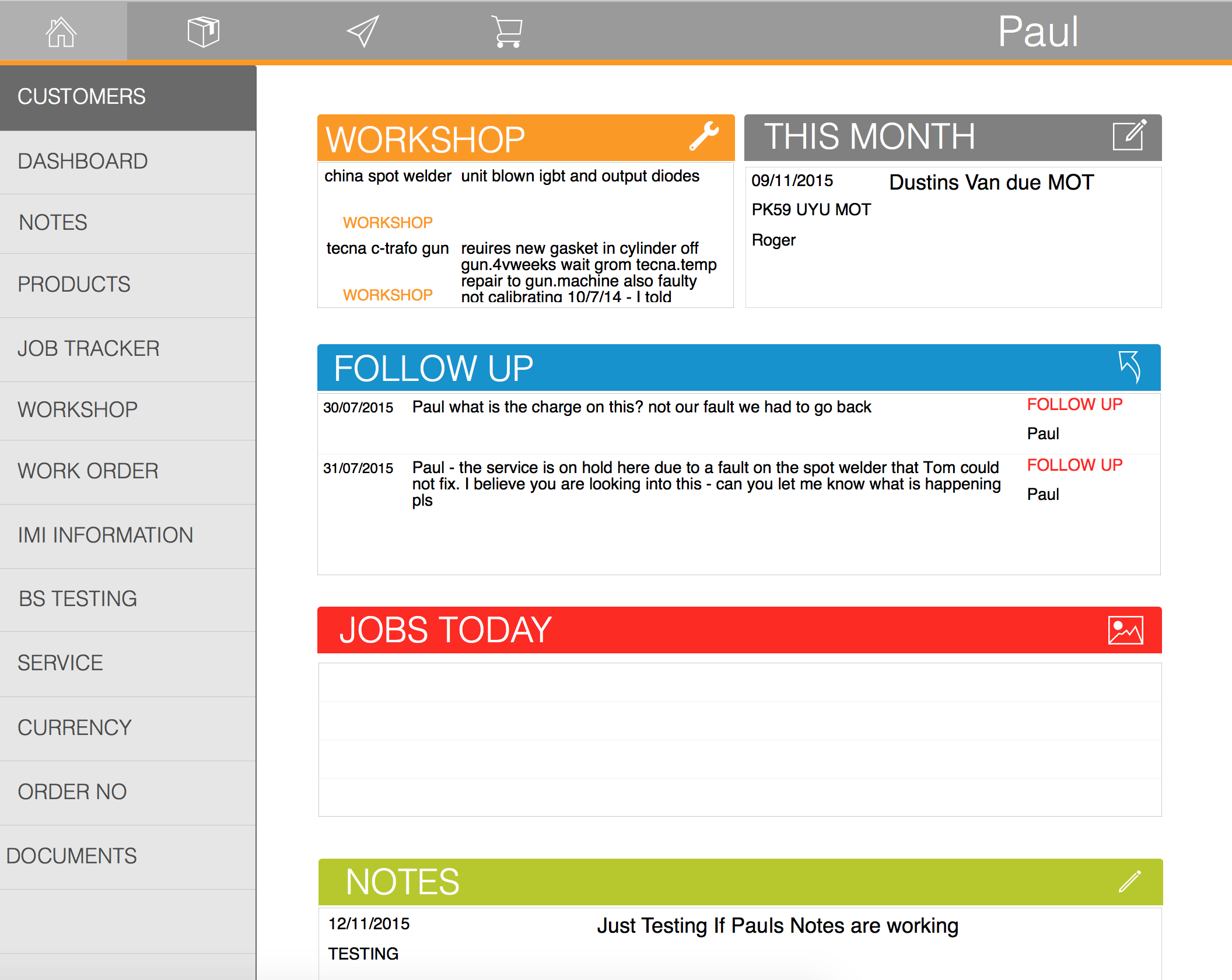

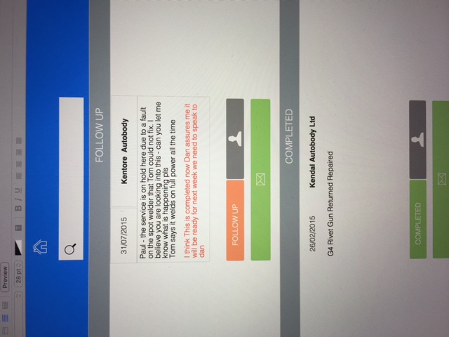

Hello i was wondering if anybody could help me , I have created a layout with work notes on it. I have written a script to find only records by name.
this works fine see enclosed.

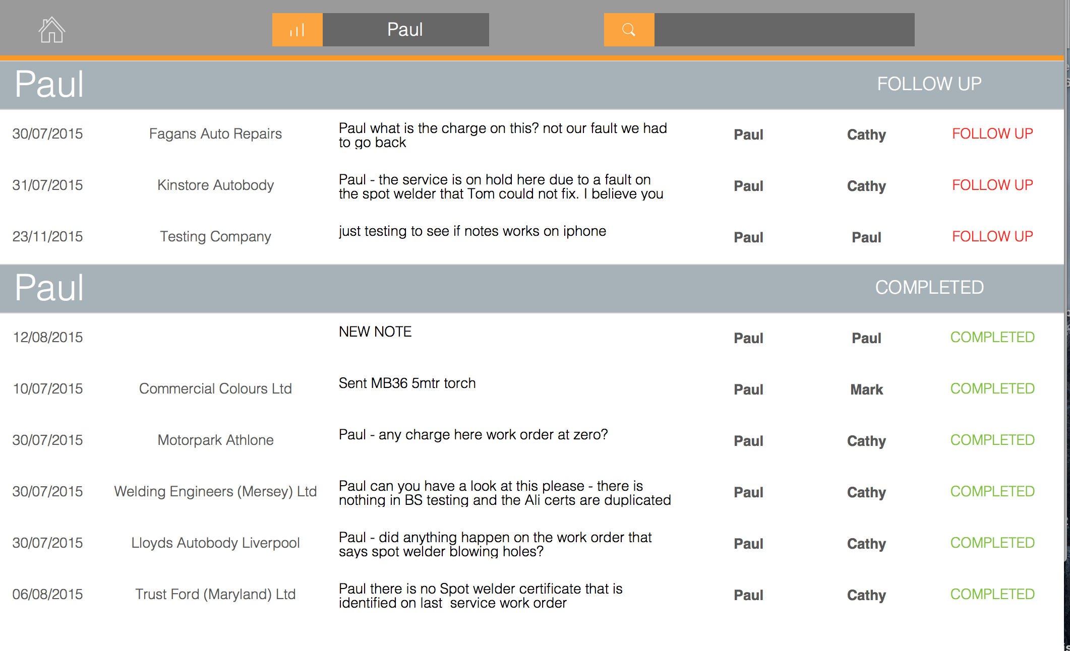

There is a status field with two options available  Follow Up and Completed. I wanted Follow up to only show.
I selected status and sort records descending and this does what i want by putting follow up at the top.

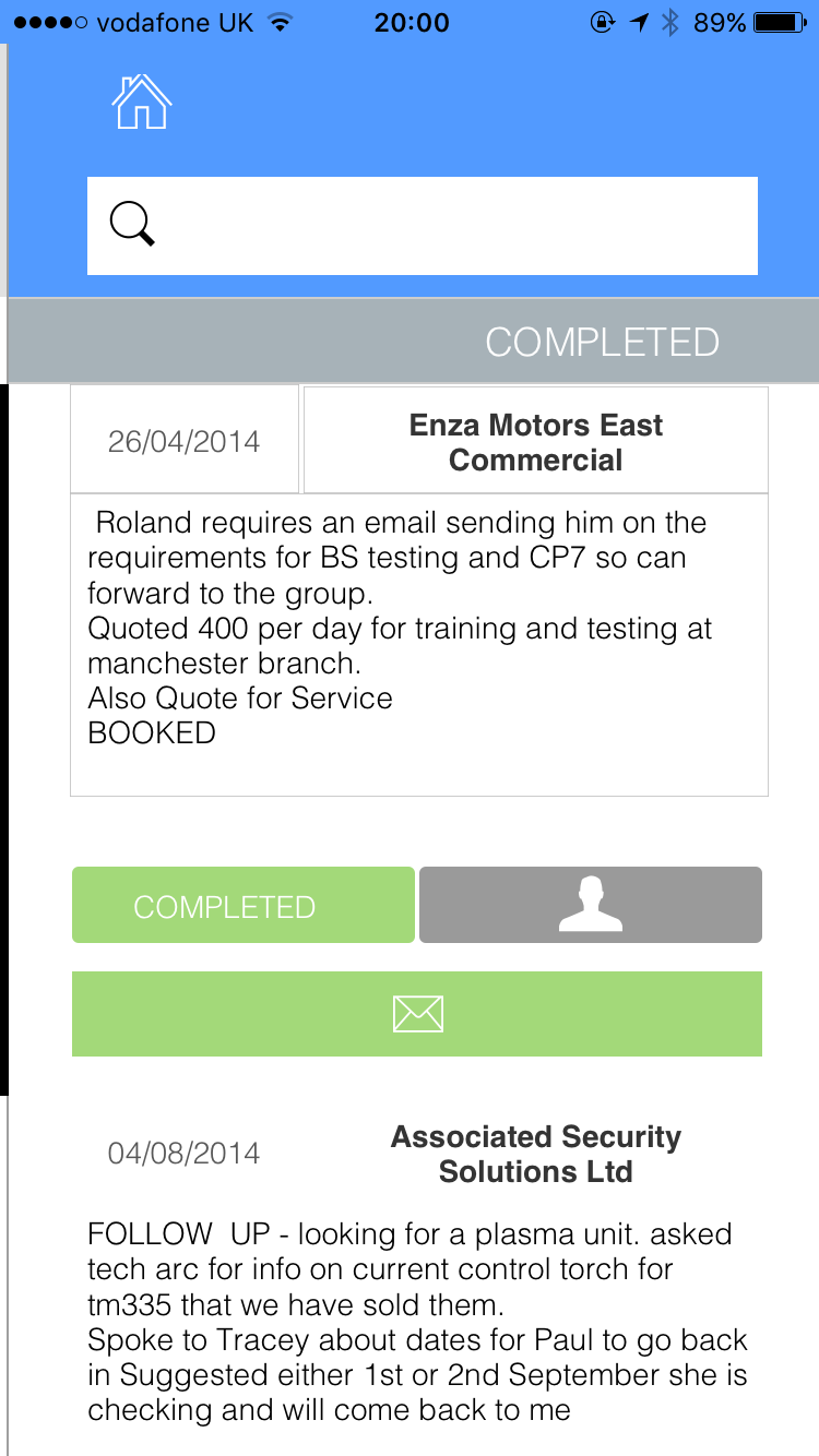

This would be fine but my problem is on my iphone. The same layout on my mac shows follow ups at the top , The layout on my iphone doesnt even show follow ups ?? only completed .
Both on same layout
any ideas ? ive tried everything
thanks

, it brings follow up to the top of the page followed by all the the completed and it works on my iphone as well
  How do i now get the layout to only show the follow ups ? and omit the completed .

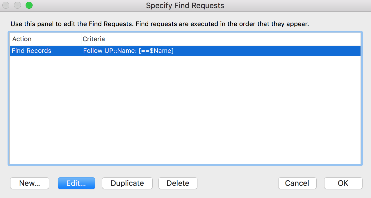

ok i looked at another copy that i had and the script that i had before was on layout enter
search criteria was set too the screen shot . then on the layout on the sort selection there is another trigger on modify to run the same script again.
This does the same as your script by bringing follow up to the top and completed down below but on this database the dashboard portal works .
I know its hard to diagnose when you cant see thanks ive included some more screen shots.

Not enough information, no file, you show a screen shot with a restored find instead of following the instructions.
