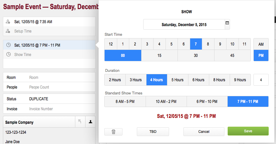

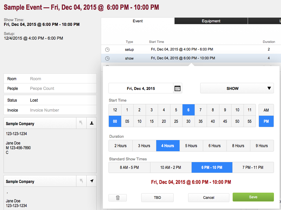

Well I played around with this and think this is a good compromise.
There is a trigger on opening the popover that sets the data fields in to globals all user interaction can be reverted by the cancel button or closing the popover.
Built a TimePicker for quick data entry.
On saving the needed data from the portal is cached into the parent record which the user has no means to edit via the main record, and yet can search and sort on freely.
Decided to start with a Popover with the reasoning that if it was just not working or i needed a "portal" (since this popover is in the portal ) i could just copy and paste contents to new layout and everything would just wire right up and use a popup window instead.
I Will probably have an indicator in the portal  that the record was synced to Outlook, then on save update the record if it is a newly created schedule prompt the user if they wish to add it to the calendar.
Waiting feedback from customer but good chance might to reduce the starting minutes to quarter hours intervals.
Simply using button bars and conditional formatting allows a quick data entry.

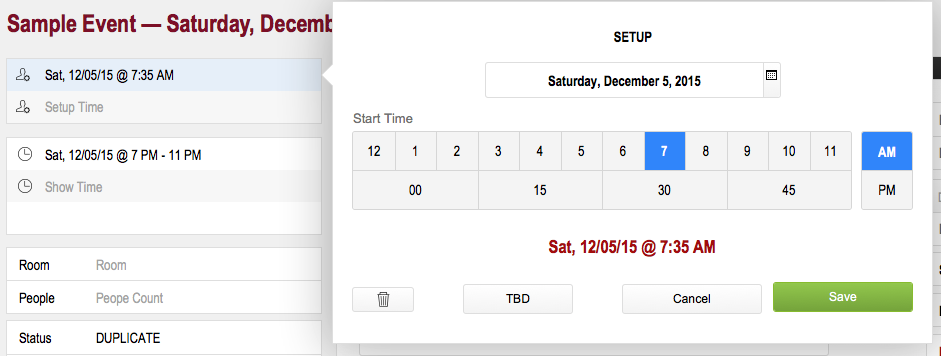

So I built it and have made two portals to separate the type of event. And am quickly realizing that any minor tweak i make to one i have to repeat in the other popover -
56631b6f51e5a_ScreenShot2015-12-05at9.06
56631b7025a6c_ScreenShot2015-12-05at9.07
56631b71af731_ScreenShot2015-12-05at9.07
Now after it's built I am contemplating a possible alternate approach - heeding the other suggestions by NOT loading and unloading globals while the user is editing the record.
If i wanted a unified interface for both types of events that I could either use a popover that isn't in the portal however i am not a fan of having a disembodied popover - it would be one thing if we could natively dim or blur the non active layer and or choose to show or not to show the connection triangle that connect to the popover, and control alignment of the popover, (essentially the same control we have with a modal pop up window ) however unless i know the end client is only using Mac at this point I refrain from using other windows because how it behaves on Windows.
The other option is to use a slide panel and put everything on one pane and then target another pane when editing content, but it makes it much harder to control exit points with out putting a lot more controls in every button's script.
I am open to suggestions.

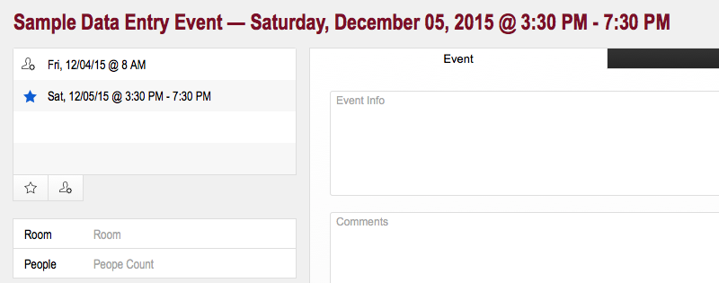

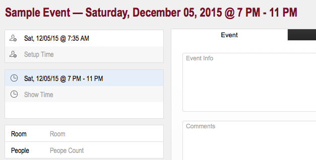

I removed creation bit on the portal so the blank row doesn't show up ( requiring scrolling if there are > 4 items ) reduced it back to one portal removed the filter and added the New buttons for each type below.
it sorts by type ( setup / show )
playing with conditional formatting on button icon to indicate possible record is synced with Outlook.
There may be a chance that the user may create a show time and based on some some logic the setup times may follow a pattern to be done the same day just hours before, or the day prior, if I can get this pinned down then the creation of a setup record could be automated to some extent.
