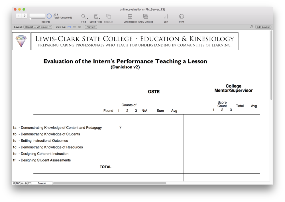

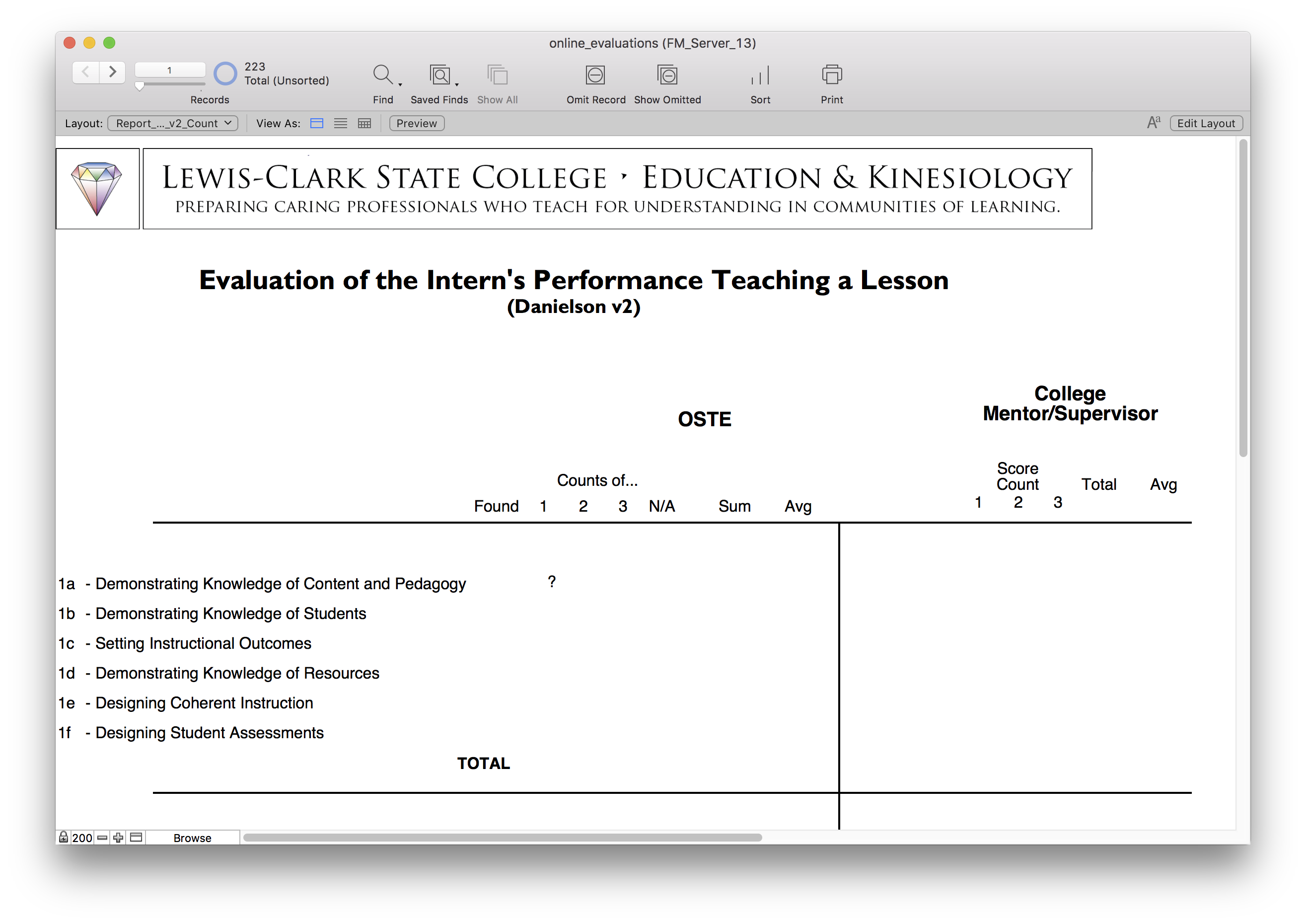

In this form, there are 17 fields where users can choose a rating of 1, 2, 3, or N/A. What I need to do count (and total) how many 1's, 2's, 3's and N/A's were assigned per question/field. For example, in Screenshot 1, for question 1a (field name: DANIELSON_FORM::_1a_DemoKnowledgeContent_value__lxt): it would have a Rating (value) of 1, 2, 3, or N/A. In Screen Shot 2, let's say there are five records belonging to a student where the entered values are 1-1-3-2-2 . Under OSTE >Counts > 1, on the 1a row, column 1 should populate with 2; column 2 should populate with 2; column 3 should populate with 1, and the N/A should either be empty or populate with 0. In addition, there are two separate sets of calcs: one for OSTE's and the other for Supervisors, so they need to be tallied separately, using the Observer__lxt field.
