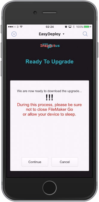

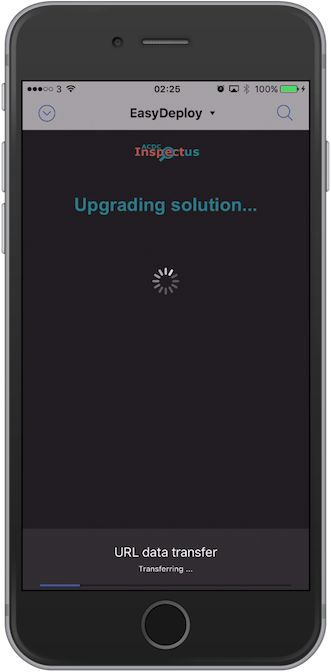

Just implemented new way of delivering the file to the mobile user.
Still it's based on the FMEasyDeploy framework.
Instead of downloading new version in segments .. or as recent proposal to copy via relationship all I am using is a DropBox link.
Server app on each new version saves copy to a dropbox folder. It remembers link and this link is only exchanged with clients.
Now all you have to do is download a version using insert from URL with dropbox link.
By my measures ~10 times faster .. and you get automatically a download progress bar at the bottom of the app.
I recommend this method to those with a large initial data set.
200MB file takes <1 minutes on 4G and ~6minutes on 3G to complete the transfer.
