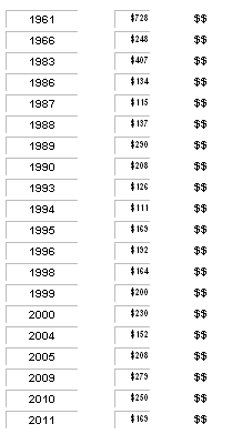

My report looks like this and it's not picking out the individual average values but I suppose a global average. Even in the detailed report it is the same - it is all $$
That doesn't tell much. Could you post a screenshot of the same layout in Layout mode?
Thanks I have managed to get this to work in a related table.
