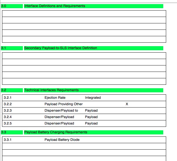

First time poster here. I have a database with 2 tables: document-sections and requirements. Document-sections has one-to-many relationship to requirements.
I have a layout that lists the first document-section and then have a portal that lists the requirements related to that document-section. The portal row is set to 5. Can the portal be setup to only have rows if there is a record there?

I am afraid that would leave out the sections that do not have any requirements - such as sections 3.0 and 3.1 in the shown example.

Interesting.  In the example shown, it includes the section numbers.  If BamaBino didn't want the empty sections to show at all, the numbers should not appear otherwise the results would look strange.
Although we can't be sure without confirmation, it sure sounds like the section headers should be included and only the portal rows omitted.  I wouldn't create a record in a data table only as placeholder either.  Unless the need includes ability to modify the requirements while condensed, preview or print would be best recommendation.  If data must be modified in browse mode, virtual table would be viable option.

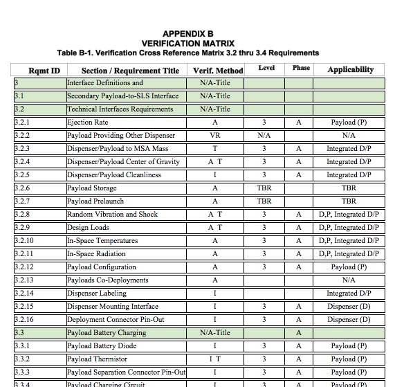

The goal is to print a report the list the first document_section (one line) then list the requirements(if any) for that doc_section (one line of data). Then do the same for the 2nd document_section, then for all the rest of the document_sections.
Like the table below. when it was just a flat-file database.
I was using the invoices starter solution to generate what I showed earlier.

Yes. All sections should be shown, even those with requirements.
Yes. Only the portal rows omitted if there is not a requirement record for that portal row.

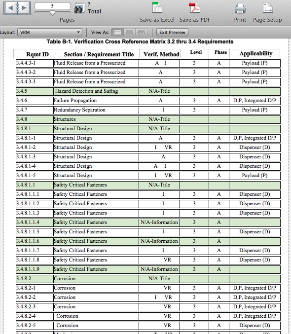

Another page from the listing back when the database was a flatfile when document_sections and requirements were records in the same table.

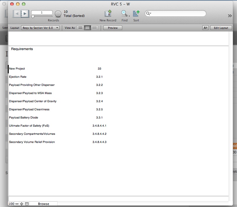

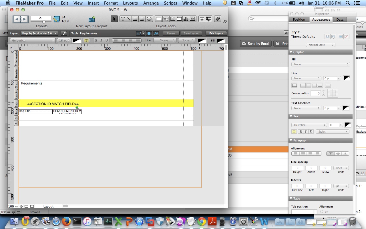

When I tried to make a print-layout like the one in the start invoice example, I must have gotten the "PART"s setup correctly.
