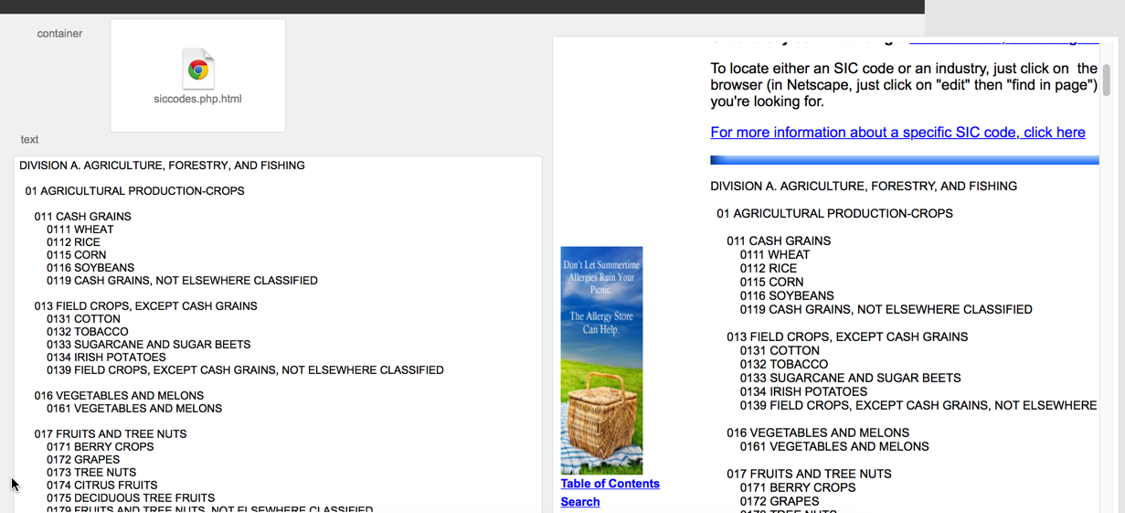

I'm attempting to pull some data from a webpage here:  http://www.ehso.com/siccodes.php
This is a one-time thing and all I really need are the 4-digit codes and their descriptions as records.   I placed a web viewer thinking this might be faster somehow but I cannot identify how to find the beginning the text.  I also am capable of horsing it and parsing each line from the copied text field but would that be quicker than web viewer?  I tried using a container and Insert From URL but once I have it in the container, I have no idea what to do with it.
My goal here is to match these 4-digit codes to existing records with those text codes so I can import their descriptions into an existing table.  I just need simplest method.  However, learning it is always worthwhile so I'm game.   I'm willing to do all the work - I just need an idea of the quickest direction and I've never needed this before so I'm a newbie.  :-)
BTW, when I copied the data and pasted it, there are spaces before and after every line.

I believe so. This took just a minute or two in a text editor (and would have taken less if I were more proficient in regex).

First, I removed leading whitespaces by selecting all and pressing Command + [.
Then I removed empty lines by replacing \r\r with \r. This wasn't actually necessary, because:
Next, I processed lines containing ^[0-9]{4} and moved them to a new document. The expression ^[0-9]{4} means 4 consecutive digits at the beginning of a line.
Finally, in the new document, I replaced ^([0-9]{4})\s with \1\t. This replaced the 4 digits followed by a space by themselves followed by a tab.
