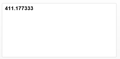

But with the same script and a full zip code (33316 for example) I get this result:
01.png.4002acad2f7af881a81701d20dda4d67.
But if I click on this field, it changes to the correct output and I can copy it like so:

So the question is, why is this field displaying only the combined address field numbers and only with more then one zip code digit, and isn't displaying the correct results?

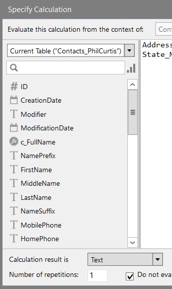

calculations default to a numbers. Change the results and text or the Field is too small for the display of the calculation..
I am agree with Lee. ;)
Change the result
Change the results to Text, that must be it because the field space is bigger then the text.
Thanks again Lee.
