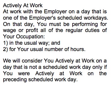

If it helps, here is one example of many instances where I need a line feed - in this case, after the 1st, 6th & 7th lines, but a carriage return after the 8th line where Paragraph / Line Spacing kicks in.
Edited by steveald

Why did you post an image of the text, rather than just pasting the text?
I was going to try some things to see if I could help, but the actual text would be more accurate then me recreating the text.
Lee, simply to show how the line spacing needed to be. Here's the text:

No, sorry. That's why I posted the image. FileMaker invokes Line Spacing settings wherever a hard return creates a new paragraph. I need to enter a line feed after the 1st, 2nd & 3rd lines in your example so the Line Spacing only occurs after lists of numbers and before headings (Actively At Work in this case). And I need to be able to do this for dozens of blocks of text like the one I gave on one page in a layout.
After much discussion here and elsewhere, it occurs to me that I may be making this harder than it needs to be. Perhaps I should just set the entire Text Object to single height Line Spacing with nothing Above or Below each line. Then just add extra lines where needed and resize them to create the effect I need.
