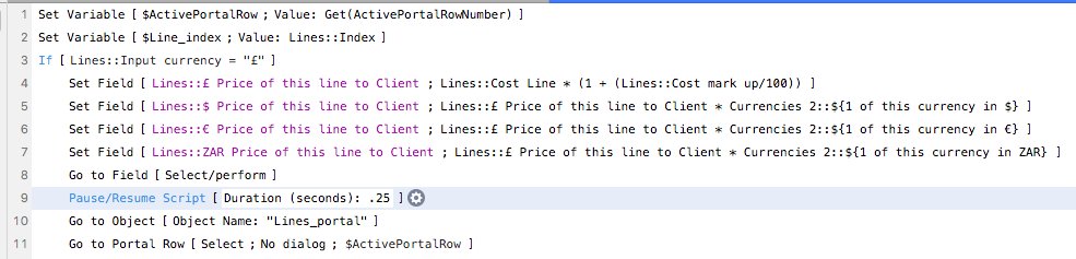

Hi Siroos
Can you see this screenshot?
The 'Set Field' steps are the recalculations going on in the other table. Actually, they're going on in the portal row. I don't change layout as don't think they're any need to.
Edited by Philip Jenks
I just tried to replicate the problem here. I did simulate your script and it works here. I am not sure what is wrong based on the screen shot of you.
I wonder if you can print the whole script or attached your file here. If you decide to attached the file, please make a clone copy so there is no confident information in it.
