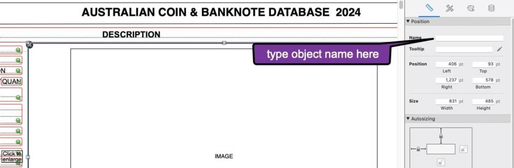

  3. So close!! Select the image popover (in layout mode). Notice that you lack the object name for the popover (attached). And sorry to tell you but ... your concept of placing the popover in the exact location will still fail if you resize the window. This just reminds me of why I was so glad when card window feature was added! Some of these old techniques were kludgy so your mileage may vary. Slide control may allow a bit more control (using anchors) and you can play with anchors on the popovers as well but it will all still be a bit messy.
  4. There IS a way to do it, Frank, but it's a bit of a hack. Attached is an example. Place the popover buttons instead to each side at exactly the middle number of the combined height. In the example, I left them yellow and remove their arrow icons. Object-name the POPOVERS themselves (left to 'Image' and right to 'Image2'. The popover (yellow) button widths can be just a few pts (left wider for demo so you can see them) and can be shorter but place them on the horizontal center. Set them to Hide by typing a 1. Resize the popover so each popover encloses entire area as you've indicated. Then place buttons below. You can replace my ugly grey buttons with your little red arrow icons. And you'll have to play around to get the size exact as you want it. AUSCOIN MOD.fmp12 Ah, I see Michael mentioned the method I displayed! 😃
