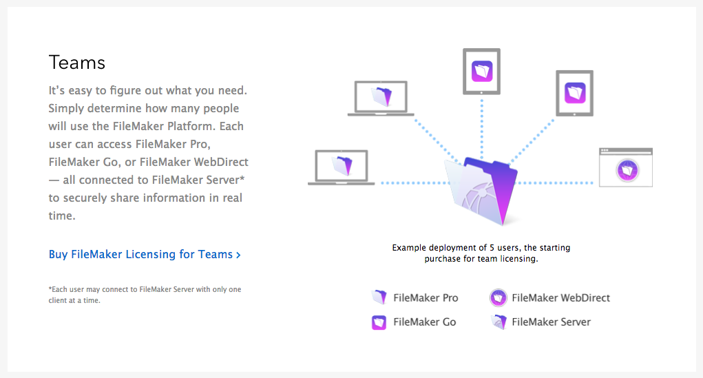

Did you ask specifically about the scenario where only 4 of those 8 employees actually access the database?
The impression I got was that you license each user that is going to access FM ( regardless of whether it's Go, Pro, WebD ).  There is still some ambiguity here, but this is what I see in the marketing pieces.
