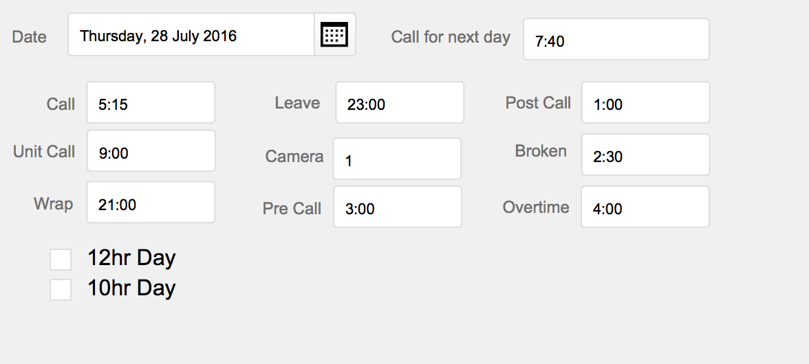

Hi
Lee from the forums kindly modified my database to help explain what the fields mean in my database. each field has a comment in the manage database section.
All my calculations currently add up as I need them to correctly, but what I now need to do is to have the following fields round up to the half hour mark.
Pre Call, Post call, broken, overtime. We are paid in half over increments for overtime which is why i need it to round up, so if the pre call is 2 hrs and 15 mins, I would need it to display 2hr and 30 mins.
Below explains what each field is for as I am aware they are not the normal timesheet fields. The descriptions are also in the comments section in manage database for each field to help match them up.
call - is my call time/arrival
unit call - this is the call for the whole unit and meant to be on set
wrap - this is the time we wrap on set
leave - this is the time I leave work
pre call - this is the amount of hours I am called before the unit call, so the difference between the cal land unit call less an hr cos we give an hour for free. So if my call is 6:00 and Unit call is 9:00 I will be on two hours of overtime - cos of of the three hours is free.
post call - this is the amount of time I give after wrapping. so if we wrapped at 6pm and I left at 8pm, my post call is 1 hr in the field, because its one hour free after that everything else is paid.
broken - after I leave work I am meant to not be called for 11hr, so the call time next day should be 11hr later, this field works out if it is less then the 11hr and puts how many hours less (broken)
on some jobs they don't pay pre calls and post calls separately, they just say you shoot for 12 hrs then you give two hours free and after the two hours are up you get overtime. So it might sometimes be different to the pre call and post calls added up... thats why the calculations takes of 14 hours worth of seconds.
In the overtime field I had an attempt at trying to round up, but it just seems to make it display 0, but I know thats not correct. Any help please. Thanks
Sarah

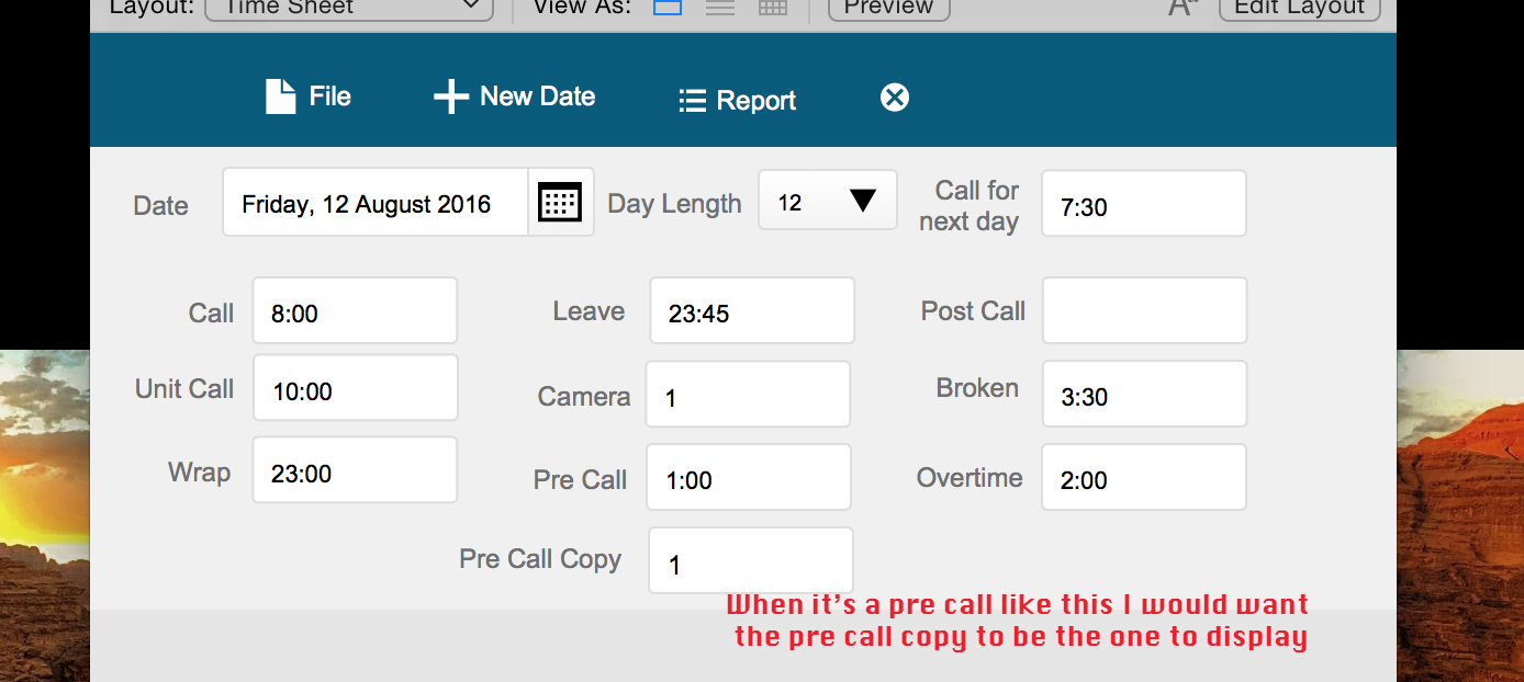

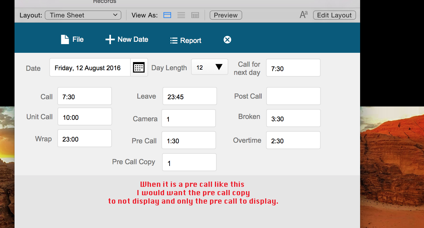

HI Comment
Sorry let me try and explain better as I am not sure how to put the rounding up calaulcation together with the case function. I have attached a screen grab of the layout.
What I would like the overtime field to work out is the following.
after I have worked either 12 hours or 10 hours how much overtime I have done. I would want to check either the 12 hour or 10 hour check box. So if I check the 10 hour check box, I want the overtime field to calculate overtime after 10 hours, using the call and leave fields to work out the hours I worked. If I check the 12 hour box then to calculate the overtime after 12 hours.
This is the calculation I have in the overtime field so far, to work out overtime on 12 hours and rounding it up to the next 30 mins
Let ( overtime = Leave - Call - 50400
 ; Ceiling ( Overtime / 1800 ) * 1800 )
So I am not sure how to use the case formula within this. I know I would need a calculation that has different second count for the 10 hours as well.
Does this description and the screen grab help explain what I am trying to go? I uploaded the file as well just in case you can now open it, but did a screen grab of the layout to hopefully help my explanation???
Thanks for your help so far it is very much appreciated!
Work Times 2a.fmp12

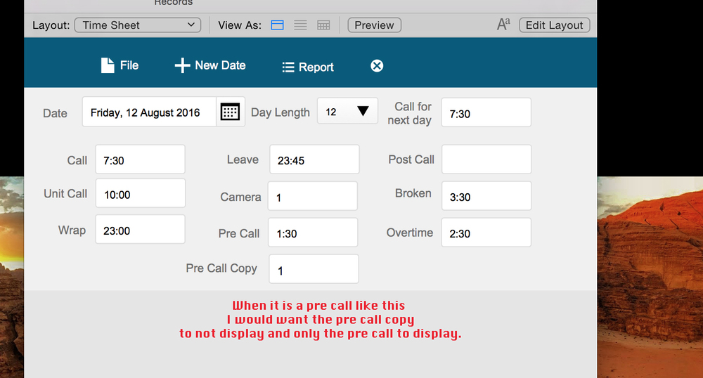

But, on second thought, you could use two instances of the same field - one formatted as hh, and the other as hhmm - and hide one them conditionally.

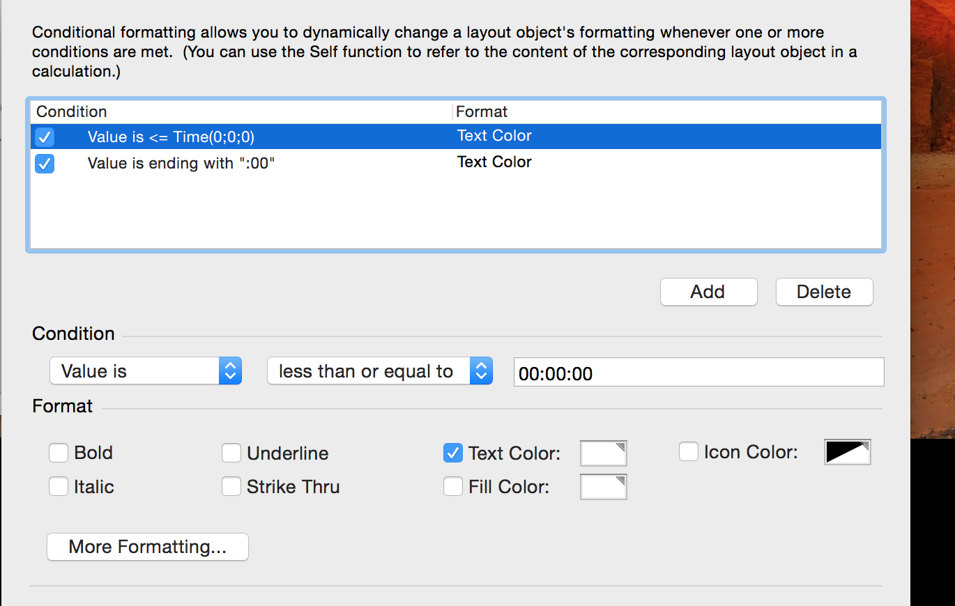

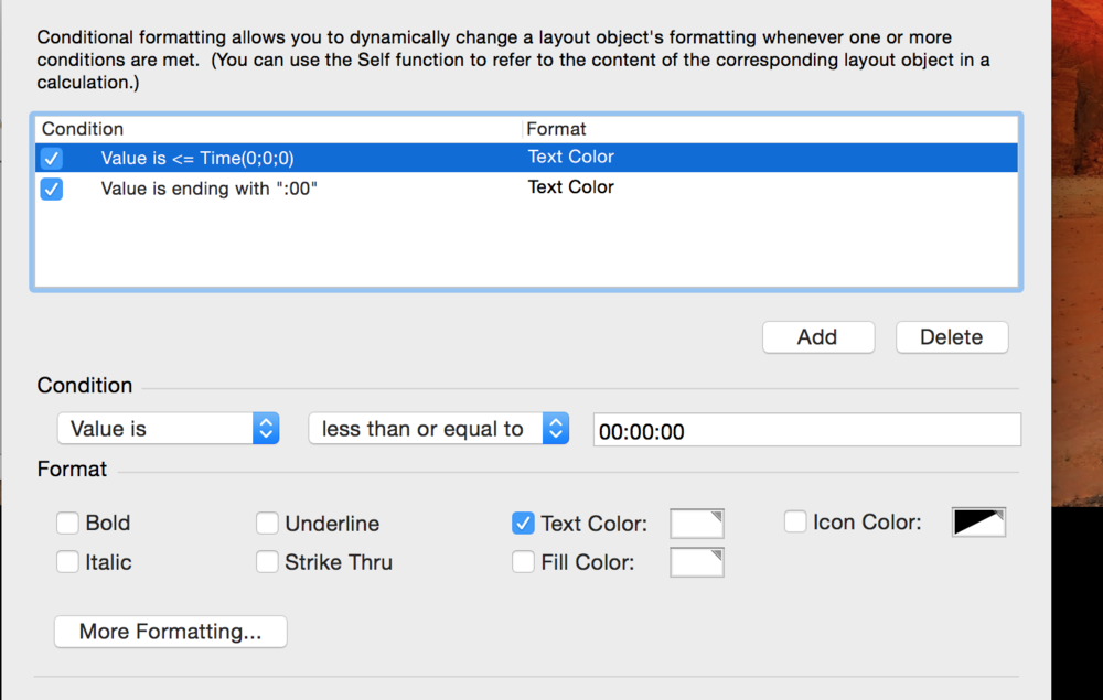

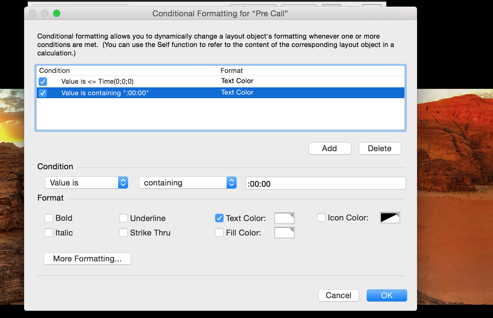

How spooky, I was just sitting there thinking hmmmm I wonder if conditional formatting would allow me to do something.....
so I did a test and did a second field to test on the pre call field and called it pre call copy. I did it to hh, and I set up the conditional formatting but not sure if I am choosing it correctly as I cannot seem to get it to work. I have attached some screen grabs showing the different fields.... once it is working I would lay the pre call copy field over the pre call one so they display in the same place on the screen.
I also have a previous formatting in it you will see where if it is 0 or less it displays the text as white so it's blank in the reports it generates.
would it not be the ending in .00 with white text to make it disappear, and for the pre call copy field I am not sure what formatting to put on it to make it white when it would be say displaying 1 when the hhmm field is showing 1:30. Does this make sense along with the photos??
thanks
I got it to work.... for both... I remember what you had said earlier about filemaker pro working in seconds only so added the 00:00 rather then just 00 and for the hh formatted one I put :30:00 and now they both work..... only managed to work this out cos of all the help you have given me this weekend which is allowing me to start seeing and figuring things out.. thank you so much
You can do it with conditional formatting - but you should do it with object hiding:
http://www.filemaker.com/help/13/fmp/en/html/edit_layout.10.22.html#1171261
Hide the hh field when:
Minute ( Yourfield )
and hide the hhmm field when:
not Minute ( Yourfield )
Not sure what you're saying here. You only need one field for this. You just place the same field twice on the layout.
oh yes that is much better then conditional as that was not allowing the text to be no fill, when set to no fill it was showing up as white so you could see white lines of the text going over the field underneath..... this works perfectly..... thank you ... I have learnt a lot this weekend!!!
I also thought I had to have two different fields with the same calculations overlaid so thanks for pointing out just one and format differently....

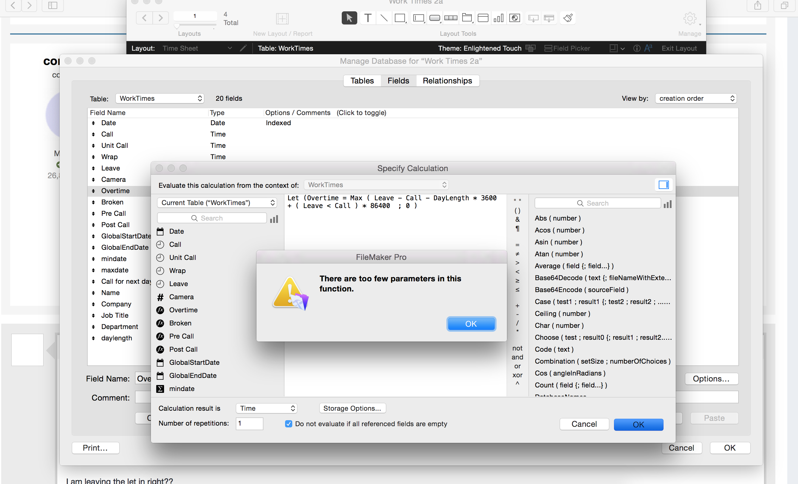

would this also work if we work nights one week instead?? as we would be called say 18:00 and leave 6:00
when I put the above in it puts this and will not let me change the calculation......
I am leaving the 'Let' in right??
Are you just copy/pasting here? Or are you trying to understand how this works? Because this should be fairly obvious to you by now.
Nope I did it from scratch as I then also added in the plus 2 on the daylight to account for the 2 hours free after that attempt above in the screen grab...
I was not sure what it meant by too few parameter as I thought it was all there...
I will keep plugging away... thanks
doh!!! worked it out, finally managed to get some sleep as I was at work last night... fresh brain and saw right away what I had done wrong.....  Thanks, sorry about my blonde moment!!!
