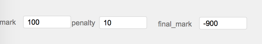

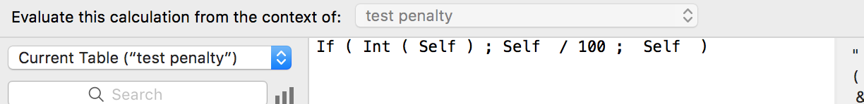

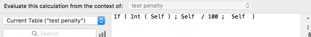

I couldn't get the Auto Enter calculation to convert the entered data to a percentage. I am not really experienced with Auto Enter calculations so I will be using the links supplied to research. I have attached screen shots - not sure what is wrong here.

On 8/1/2016 at 5:49 PM, LaRetta said:
Since I don't know your level, I'll add ... Auto-Enter (replace) simply means to uncheck right below the auto-enter calculation value 'do not replace existing value if any.'
Look at your second screen shot.  You have it checked and it should be unchecked.  :-)
As Pooh Bear once famously said "I can't read" Thanks very much. Works a treat.
