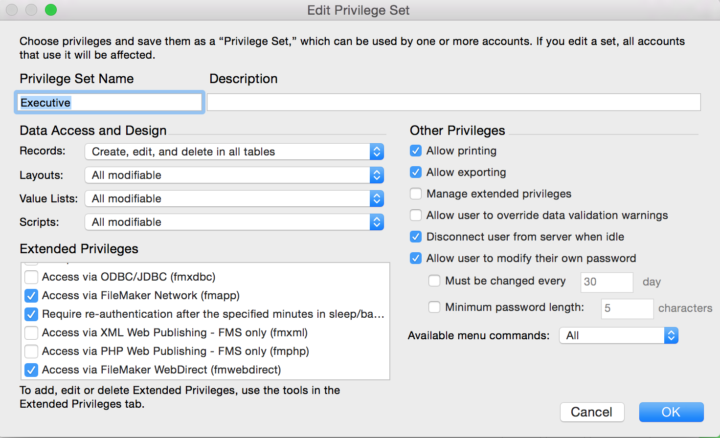

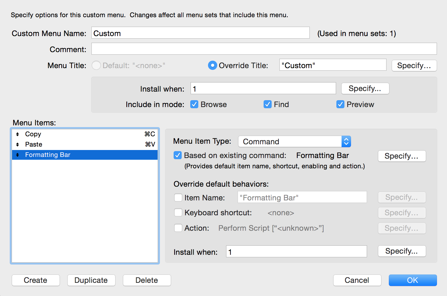

I've attached the "Security" pane and the "Custom" menu pane ... please see attached.
In the custom pane I even tried added the "Formatting Bar" but that did absolutely nothing other than true "On or Off" the formatting bar.

Here is the answer for those who are interested.
philmodjunk suggested that I post on "FM Problem / Trouble Forum" which I did and Fred(CH) responded with the following solution.
Apparently I failed to "Add" the "Format" to my custom menu set. When the "Format" was added to my custom menu set the "Formatting Bar" became active when the user clicked into the "Text" fields.
Please see attached pdf.
Thank you philmodjunk for your suggestion.  And a special thanks to Fred(CH) for your insight.
