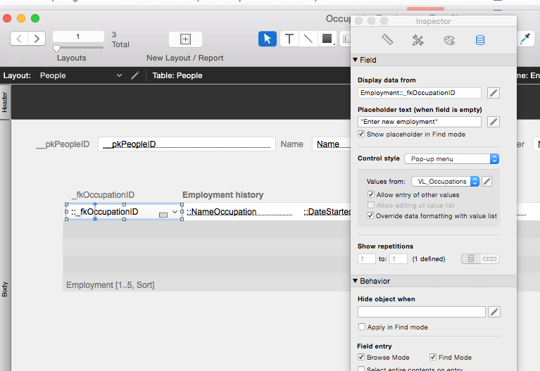

Not too hard - in Layout mode, just under where you define which Value List to use, is an option to Allow Entry of Other Values - seems to work nicely if you tick that
@Webko  Yes but does that create a new record in Occupation?
From my testing of the given file, yes

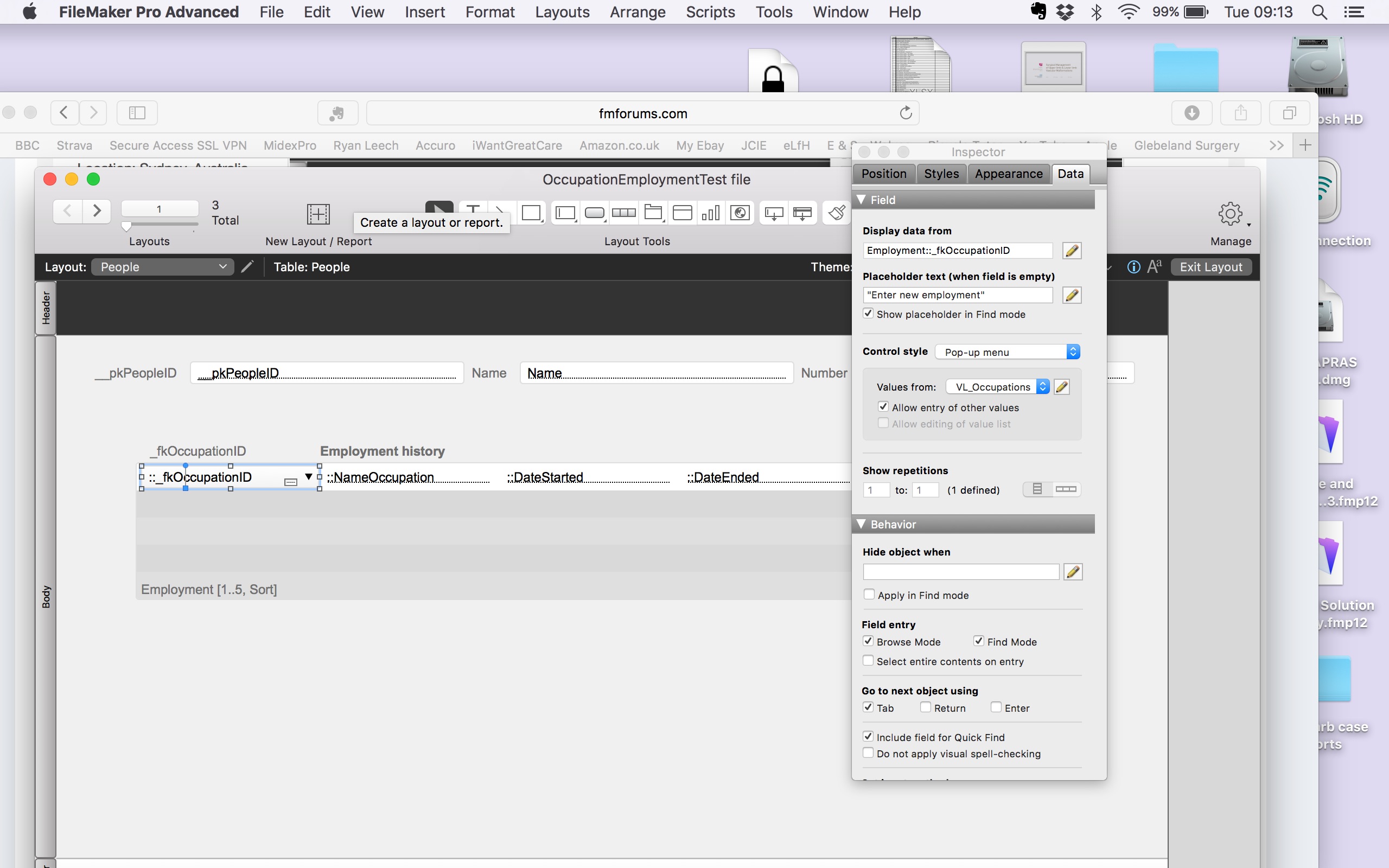

I had tried this technique and it is not working correctly for me. Whilst I can create an occupation in the portal window this does not transfer to the occupation table. Also in the Employment table this creates a fkOccupationID that is the name of the occupation rather than the serial number represent a new record.
When I look at your screen shot you have an option ticked that is not available to me, "over ride data formatting with value list" - could this be the difference? I have attached the file again set up as you suggested and a screen shot of my window to show the settings
Garth
OccupationEmploymentTest file.fmp12
Webko: try again. Looks like you're wrong, it does NOT create an Occupation record.
Not sure what your expectation is.  By using the "other" option in the value list you will NEVER create a record in the occupation table.  By entering data in the portal itself, you are forcing the creation of a related record but only if you use a field that exists in the Occupation table.

It doesn't... and it does - I also filled out the next field in the portal, which does then create the record in Occupation
But as noted, the FK is whatever was put in the Other option, and the display is whatever was put in the next field - so scripting it to work correctly is definitely the way to go
