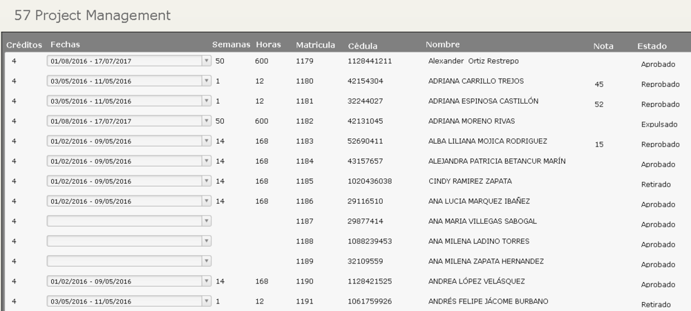

This is the portal (it's in spanish):

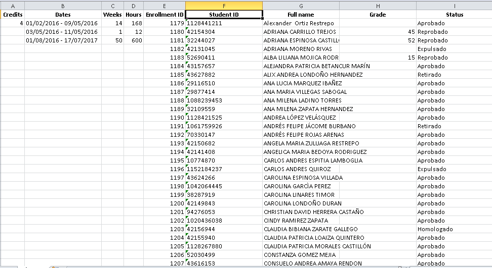

this is the export (I put the field names in english):

Ok, look at the excel picture, the first 4 columns are missing information. Apparently the information is grouped so no information is repeated
As Wim said, if you want your export to have parent data in every row, export from the child table and include the parent fields in the field export order.
