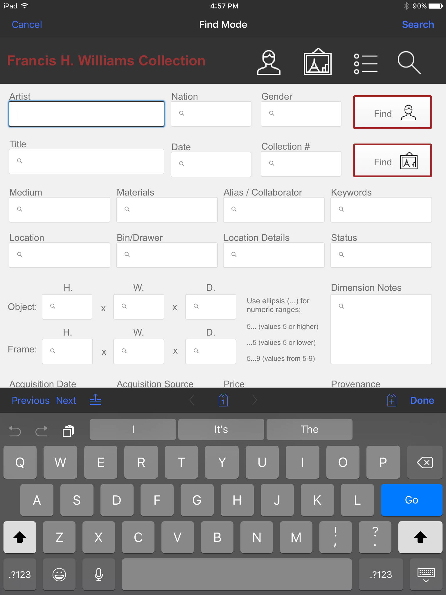

I'm revisiting a Filemaker Go solution I put together a few years ago where I implemented a clumsy workaround for a problem I couldn't figure out.  I have a database that stores ARTIST records and child ARTWORKS records, and I have a layout with a bunch of searchable fields drawn from both tables so that the user can search for, say, American (Artist field) & Watercolor (Artwork field)
I'd like the user to be able to specify whether the Find will display a list of ARTISTS (American watercolorists) *or* ARTWORKS (Watercolors by Americans).
Currently, I have two buttons on the layout, so when the user enters his search terms, he taps the appropriate button and a script takes him to a layout with the appropriate context and results (I put a Script Parameter on the Find Artists button).  This works okay, but it is really inelegant and non-intuitive, because in Find mode the Keyboard is on display for entering the search terms, including a big blue irrisistable "GO" button that invites the user to execute the search -- which is of course not going to do what I want it to do.
Is there a way for me to use a Script Trigger that would intercept the Find action and perform my branching script instead of delivering the native Find based open the current context?  I haven't been able to figure it out -- perhaps an OnModeExit? I've gotten kind of confused about what happens to the search result and when a script might intervene.

Ack -- I'm either not getting my situation across or just missing the obvious -- the "Button" is on the slide-up keyboard on the iPad -- is it possible to attach a script to a button that is not on the FIlemaker layout, but on the built-in iPad keyboard that appears when you type in any app?  As far as I'm aware the 'Go' button just executes the search?  Here's a picture of the screen -- you can see the buttons I set up and how they are 'upstaged' by the ipad-native 'Go!' button.
