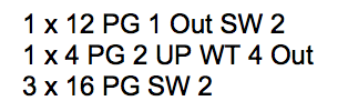

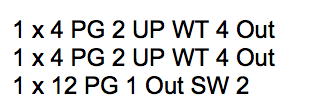

The "Distinct" changes the sort;
1st image - without "Distinct" the "List" stays by creation order, but we list the first two items twice.
2nd image with "Distinct" for some reason, the "List" sorts and we get the "List" but incorrect order.
Anyway, if there is any guidance here I would be grateful.
Thank you.

I wasn't able to reproduce your results, but that was using the BaseElements  plugin, not Filemaker's native ExecuteSQL() function.
In any case, I gave you an alternative method.

I'm having a hard time following overall what you are doing based on your previous posts.  Perhaps a sample file would be beneficial.
As for a particular order for the DISTINCT, if you have a serial ID and ORDER BY that field then it should sort by the order that the records were created.

ExecuteSQL ( "SELECT DISTINCT fruit FROM yourtable ORDER BY recID"; ""; "" )
should work.
  • 5 months later...
mr_vodka,
Yes ... "Distinct" creates only "ONE" unique value and "Order By" puts the result in the correct order.
